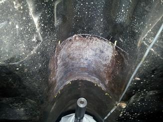

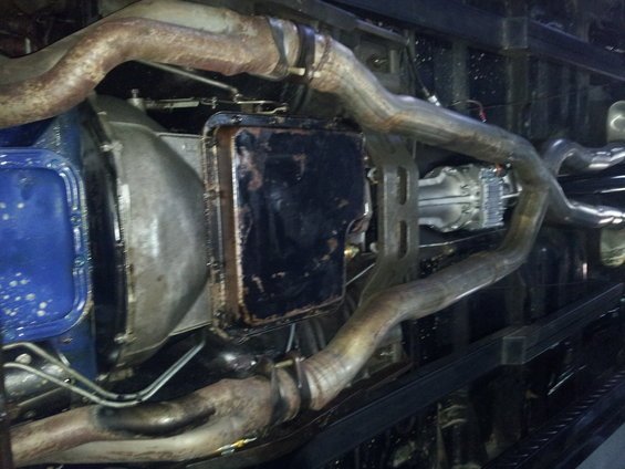

I've also begun the Gear Vendors install so far I had test fit the tailshaft and the o/d to determine if I would have fitment issues which (despite their claims) I did so I marked the area that would need relief then took a chisel tool from an air hammer and blunted the end and used that to massage the trans tunnel. Another test fit and all was good! The rest of the install was a cake walk.
tunnel clearanced
GV installed
GV install completed

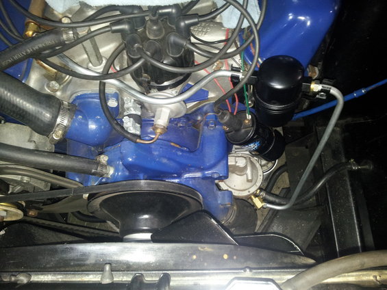

  Original interior with new Moss Green carpet and Dark Green floor mats installed
  Carl's Ford Parts 427 fuel canister installed
