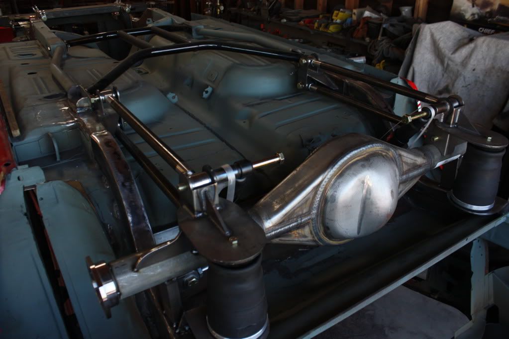

Okay is it set in stone where  the driveshaft hoop needs to be placed under the car? This is on my 64 Fairlane tbolt clone. The rear incorperates the hoop  on the traction bars but I believe You have to run one in the front to be legal  for NHRA class.

Marc is correct, with a little clarification - rule is WITHIN 6 inches of the center of front u-joint. So for example 2" behind, 4" behind, etc. up to 6" all good. Just pointing it out because sometimes a floor brace, emergency brake cable, and so on might be in the way at exactly the 6" spot. And although not required by the rules for most cars, a rear loop like you have is a good thing. I've seen race cars break a driveshaft in half and that foot or two of spinning broken rear shaft attached to the rear end will absolutely tear the floor out of a car until you get it stopped.

No, you did just fine. 2" x 1/4" if flat steel or 7/8" .065 wall welded steel tubing is the rule. I was remiss for forgetting that detail, thanks to Steve P. for bringing it up. And Steve's memories are legendary, but not always something you want to rely on ;)
