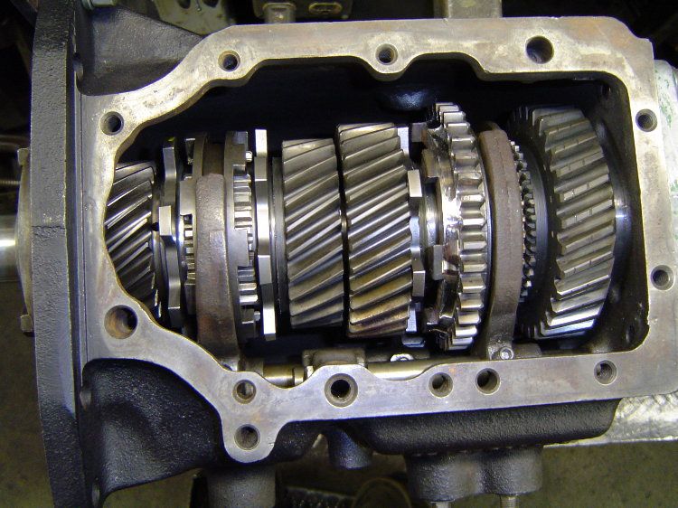

The face plate lugs should be similar to the one below. This is what I have planned for my toploader when the time comes. Notice the lugs have a tapered edge to hold them together to prevent popping out of gear.

According to Liberty when I spoke with them about this a few years ago, all of their 1000+ HP transmissions will come out of gear on decel.
A Gear Vendors overdrive uses a cone clutch, completely different design than a Lenco.
