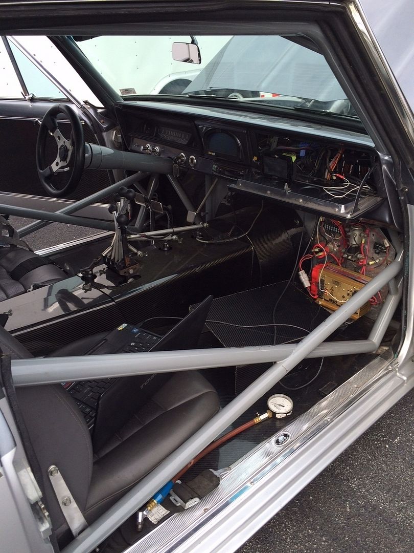

I'm no expert on Lenco's, but I do know there is one in Larry Larson's Nova and he's done ok at Dragweek, must be streetable somehow.
Horsepower drag was only one reason NHRA Pro Stockers went away from the Lenco and the resulting ET improvement  - overall weight reduction was one and the desire to keep the engine in a narrower powerband was another.
Well, if I wanted to deal with the trans popping out of gear every time I took my foot off the gas while going from one track to another, I could run a Liberty or a Lenco at Drag Week, but I just would rather not.  At that point I'd live with the automatic.
