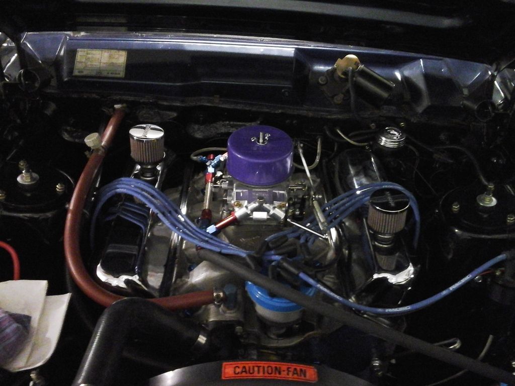

On my iron headed FE, I have been using a carb lift plate for years to Re & Re the engine complete with flywheel, clutch assembly and (heavy) Lakewood scattershield in my Fairmont. I just use the 4 carb studs in my almost 50 year old Ford Sidewinder aluminum intake manifold, with no issues.
On my SB 85 Mustang, I use the same carb lift plate, and install the engine with the clutch, scattershield, starter, and passenger side header, which requires an extreme nose up attitude, again using the 4 studs on the aluminum intake manifold, with no problem.
