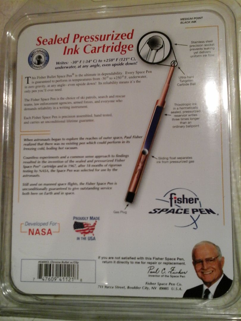

Reminds me of something from NASA, not sure if entirely true. NASA wanted something that can write in zero g environment, so they commissioned a company to create the space pen (which is true).
Funny you should mention it, I just happen to have one. Lol. I think you can get them at Staples.
