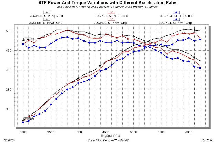

I know I'm beating this to death, but I really enjoy the topic of parasitics, harmonics, etc.  So I have one more piece of data that some people may find interesting.  Quite a while back, my "dyno mentor" explained to me how you could actually determine an engine's moment of inertia on the dyno.  Any modern dyno allows you vary the acceleration rate of the engine.  For example, my Superflow 901 dyno allows you to accelerate the engine at rates of 50 RPM/sec, 100 RPM/sec, 300 RPM/sec, 600 RPM/sec, 1000 RPM/sec, etc.  You will see different torque and horsepower levels from the engine, depending on this rate, because the faster you have to accelerate the reciprocating assembly, the more torque that will take, and therefore less torque will be available for the dyno to measure.  After talking to him about this (in 2007), I ran home and ran the following test:
The test was done on my 390 stroker dyno mule, the 500 lb-ft and 500 HP engine that I ran many of the tests on in my book.  This is the same engine in back to back tests, done at different acceleration rates.  As you can see there are some variations along the RPM curve, but if you average the torque numbers from 3000 to 6000 RPM for each pull, the difference between the 100 RPM/sec data and the 600 RPM/sec data is about 25 lb-ft.
So, to calculate moment of inertia for this engine, while it is mounted on the dyno, we need the angular rate of acceleration in radians per second, of 600 RPM/sec and 100 RPM/sec.  So, (600 X 2 X 3.1416)/60 is 62.8 radians/second squared for 600 RPM/sec, and 10.47 radians/second squared for 100 RPM/sec.
We will call moment of inertia MOM for short.  So, MOM X 10.47 + 25 lb-ft = MOM X 62.8.  Solving for moment of inertia gives 0.477 for this engine.
As a check I plugged my weight estimates for this engine into the spreadsheet, and got a difference of 19 lb-ft between the two acceleration rates, not 25.  However, the spreadsheet does not take into account the part of the dyno that is spinning when the engine is running.  The engine of course has to accelerate the dyno's input shaft and water pump impeller, along with its own internal components.  If I change the value of the clutch plate weight in the spreadsheet from 10 pounds to 40 pounds to try to compensate for this, then the spreadsheet gives the 25 lb-ft difference.  So maybe the dyno's internal parts weigh 30 pounds, or maybe my weight estimates are off somewhere in the spreadsheet.  In any case, its pretty close.
You hear all kinds of things out there about the value of lightweight reciprocating components, but rarely any specifics, so I took this data and made the calculations to try to nail this down within some range (before I spent a bunch of money on titanium connecting rods LOL!).  FYI, I normally run all my dyno pulls at 300 RPM/sec.  Also, given the moment of inertia calculations, it is obvious that in first gear on the racetrack, where the engine is accelerating quickly, you will see a much bigger loss due to inertia than you would in third or fourth gear, where the engine is accelerating more slowly.  If you had the dyno data for the engine at a couple of different acceleration rates, you could take a stab at figuring out how much difference it makes.
OK, I'm done.  Sorry... ;D

So if you take gear out, it accelerates more slowly, but makes more torque, which accelerates quicker?  Right?  About that lakefront property in Florida?  LOL Joe-JDC
Actually that's right Joe, but the small amount of additional torque you get from accelerating the engine more slowly is far outweighed by the massive amount of torque you lose to the wheels by gearing down.  If there's one thing that the moment of inertial calculations point to, its that it is not that large of an effect.
