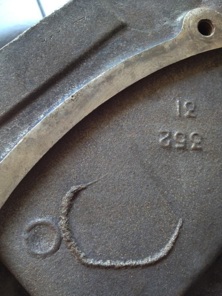

« Reply #10 on: July 09, 2015, 01:52:38 PM »
Kevin was talking about the back of the block itself Mark.
If it had a mark like this (or an A, could be unreadable also) then you would prolly have a 428.
I have a good friend that just bought a Q wagon and found it was a 390 replacement.

"Could be a 410 or a 352"...These have different flex plates.The 410 would have the external weight as the 428.
FirstEliminator
  • Posts: 463
Re: 428 crank
« Reply #12 on: July 09, 2015, 05:51:28 PM »
   I was noticing the back of the block had paint on it. I didn't notice anything that looked like that deflated C.
   410 has external balance?---well, 352 or 390-----probably a 390.

Re: 428 crank
« Reply #14 on: August 05, 2015, 01:15:55 PM »
It sure would have been nice if Ford would have just cast a big "428" on the outside of the block, but they didn't. My first bit of advice would be to check out 428cobrajet.org - best place by far for info on these motors. Here's a link right to the engine block I.D. section, but the whole site is a good read.
http://www.428cobrajet.org/id-block
