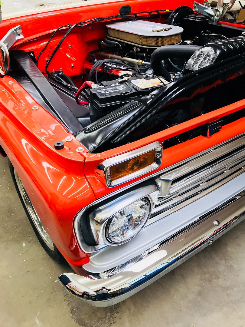

« Reply #154 on: August 14, 2018, 10:18:04 PM »
Few pics with hood off for better lighting. Still with cell phone so not super high quality pics but show stuff pretty well.
