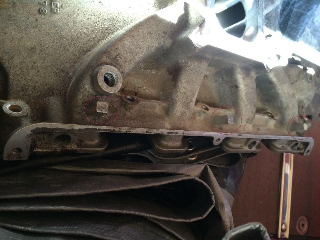

Second are these three square projections on one side, only two on the other. Any idea what they are for? Circled in red.

The water jacket on the FE only crosses over on the front.
The little tabs are for the machining process.

I already gave my stock intake away so didn't realize the water jacket for it didn't cross over. Curious then why the block has a rear opening (the intake has the corrosion marks on the rear from a water inlet).
What machining would the tabs be used for? I've not seen them on any other make of intake, but when I looked up Street Dominators for other engine types, most had them.
They are for supporting the intake as it is production machined. I had a look at a C6 "Big S" intake and it has locating tabs on both sides.
I think you will find that most intakes have some sort of locating tab for holding it in place for the machine operation.
Cylinder heads, blocks, and for that matter pretty much any casting will have a register tab for setting it in the holding fixture.
By the way, there is a procedure for opening up the plenum on your new intake which is good for an extra 500 hp and a $1000 in the wallet.
But if you show a picture of the big hole we can figure out if someone has already done this and you won't be cashing in.   ::)
