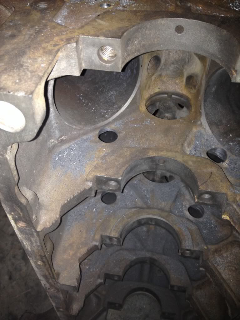

Enter my 352:
Yep.  That 352 in the bottom of the picture.  I bought it out-right (didn't make payments) from a forum member around the middle of 2013.  I had plans of taking it straight to the dyno and just treating it horribly, but after I pulled the valve covers, I didn't want to take a chance of scattering it and making a mess of the dyno room.
It was a turd....
I've always wondered what a real hipo, high rpm 352 would sound like and since I have a bunch of spare parts laying around, I decided to do some tinkering and playing.  I also wanted to use the engine as a "mule" and showcase some other things I've been pondering.
Ok, so I stripped her down, and had the block baked and tumbled.  I sent the crank to Adney and had him turn the rod journals down to BBC size and to do some other work to it.
When the block came back, I tapped all the passages for pipe plugs, massaged this, massaged that, then did a half fill with some Moroso block filler.
You don't see a lot of published cases of cylinder vents in FE's, but they do them with LS engines, Modular Fords, Cummins, etc., so I added those as well.  Since they are in so many factory and aftermarket blocks, I don't feel like I'm betraying any speed secrets by mentioning them here.  If you're not familiar with them, they allow adjacent cylinders to scavenge and equalize pressure.  What's it worth?  A little bit of ET...
Had it line honed with ARP main studs, square decked, bored and plate honed to a final bore size of 4.060".  Starting to look like a nice piece.  :)

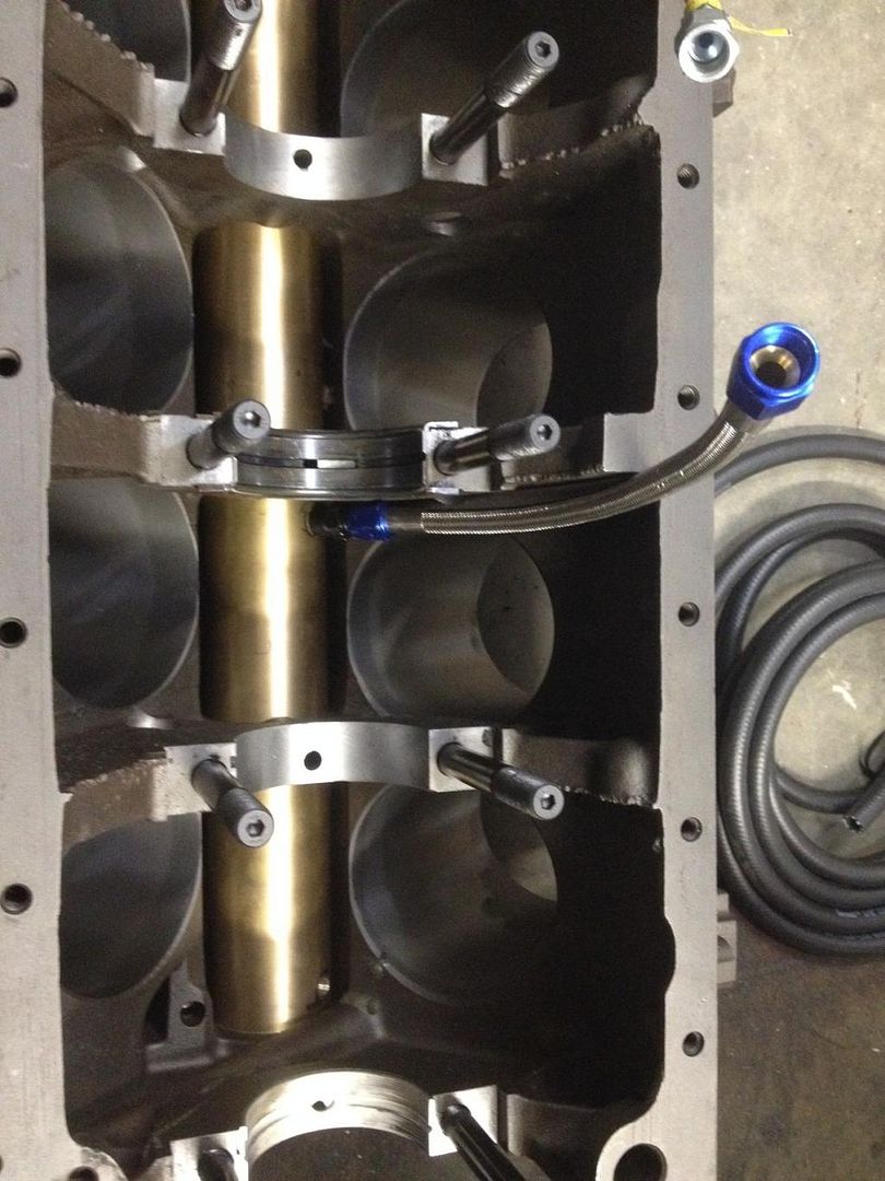

I had an idea in my head for the longest time about another method and basically came up with a REAL enclosed cam tunnel for an FE.
I threw around some ideas, did some brainstorming, then ordered up a tube of bearing bronze and shipped it to my buddy (and forum member) Wade White.  Wade is a master machinist and has access to some cool toys, so I felt very comfortable working with him.  Wade also does all of my custom valve covers, so I'm familiar with the quality of work that he does.
An FE block has different sized cam bearing OD's.  That makes things tricky, but it also lends itself to a fully functional drop-in enclosed cam tunnel.  I measured up some cam bearings, factored in some press fit dimensions, calculated some area for a distributor gear to fit, drew it up on AutoCAD, then sent the drawing to Wade.
Out came this:
That was the first draft.
The design intent is to drop the tube in until the last 5/8", then due to the stepped IDs of the cam tunnel, it's then a press fit.  This allows you to get the tunnel started in very straight, located correctly, then locked in without much effort.  I use a roller cam bearing tool to draw it in, and the good thing is, you can draw it right back out so that you can clean the block easily.
So, after I got the first one in, I had to do some more brainstorming.
1.  How do I oil the cam?
2.  How do I drain the oil that's in the tunnel to keep the oil temps from creeping up and to keep from filling the lifter valley with oil?
3.  How do I keep the oil in the valley from raining down around the tunnel?
4.  How do I finish the inside diameter of the tunnel?
Here are the answers:
1.  I drilled small holes in the tunnel that line up with the feeds in the mains.  It will oil like a regular cam bearing.
2.  I drilled and tapped (2) 1/4" NPT holes, one on each side of the thrust bearing, on opposite sides of the block.  These holes are tucked in close to the #3 main bulkhead and allow the use of a -6AN fitting, hooked to a -6AN hose, which is loop clamped to the block bulkhead, then the hose drains directly into the oil pan, away from the crankshaft.  I'm using a highly modified FT bathtub pan, and the drain hoses drain directly to the pickup.
And yes, the rotating assembly clears them.
3.  The drain holes in the valley of the block are plugged with 3/4" cup plugs.  The holes at the front and rear of the block are left intact, so what little oil that's up there can drain to the timing cover area and to the very rear of the block under acceleration.
The heads are drilled for external drain lines, so that they don't drain to the lifter valley, but straight to the pan.
4.  This is the tricky part and you have to have access to some highly specialized machining tools.  I do plan to offer these, but keep in mind that you will have to work hand-in-hand with a machinist that has FE specific tools, such as a BHJ lifter tru fixture for an FE and a way to press in bronze lifter bore bushings.
The block lifter bores get drilled for the OD of the bushing.  The tunnel then gets pressed into the block, and then the same fixture is used to cut the lifter holes into the tunnel.  Once that is done, then the lifter bore bushings are pressed in and they extend down into the tunnel by a small amount.

With the cam tunnel and lifter valley essentially sealed off, crankcase pressure will need to be vented by other means.
Once the bushings are in, then the ID of the tunnel needs to be bored/honed to fit the FE camshaft size.  Again, a specialized fixture is used to align both the crank and cam tunnels and everything is made perfectly straight and true.

Hopefully you'll excuse the dumb question.  Does that sleeve replace the cam bearings?
  • Posts: 5399
Re: Project Rusty Junk
« Reply #3 on: March 09, 2015, 02:27:07 PM »
Yes, the tunnel is the "cam bearing".
I explained this in a follow up post on the other forum, but the mains feed to the tunnel just like a regular cam bearing.  The front of the tunnel has an additional hole for distributor oiling, and a groove connecting the two holes, along with a groove to the timing set.
« Reply #4 on: March 09, 2015, 02:31:04 PM »
Another dumb question.
If the cam tunnel is fed off the block oil galleries, how do you keep the tunnel in place?
Is it that good of a press fit?
OOPs
Upon rereading, the holes in the tunnel are grooves so that if it rotates there's no big deal. Is that correct?
If so cool. Well, it's cool no matter what.

It's a press fit.  It can't rotate, and if it did, then it would bind all the lifters up.  :)  The lifters go down into the tunnel through the lifter bore bushings.

That's a really cool project, Brent, and I'm looking forward to seeing how it works out.  One thing I'd be concerned about is draining back the oil from the cam and lifters through those 2 #6 tubes.  Do you think those tubes will be enough?  And wouldn't you need them between each pair of cam journals, not just in the center?
  • Posts: 5399
« Reply #14 on: March 09, 2015, 06:49:20 PM »
Jay, it's probably not the most perfect scenario, but I think it will be adequate based on some other experiences I've had.  From what I've seen and think, oil moves quite freely through there, based on acceleration, deceleration, etc.
In a drag race small block, we use pieces of sheet metal between the bulkheads, made like a half-pipe, and they are epoxied in place.  Usually in the rear, we use a 3/4" piece of tubing to drain.
If it does raise the oil level and get into the valley a little, it shouldn't hurt anything, or if the level gets up, it can spill over onto the distributor gear.  The heads will drain straight to the pan and the top end will oil through the lifters/pushrods.
I think Jon Kaase used some pieces of sheet metal epoxied in between roller cam bearings in an EMC BBF.  He had one large 3/4"-ish drain at the rear of the engine and it cycled the oil just fine while just being a dyno queen.   Of course the sun always shines on Jon, but hopefully I can catch some rays too.  :)
I did try to fit some smaller drains in the front and rear, but it was basically impossible due to how close the counterweights came to various points on the block, and the shape of the block itself.
