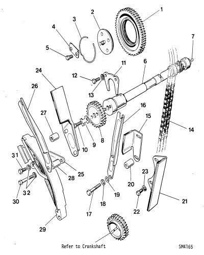

Is there an option similar to the old Jaguar cam timing gear?
Re: FE Timing Covers
« Reply #65 on: April 30, 2016, 08:57:25 AM »
I'm not familiar with that one, do you have a picture?
chris401
« Reply #66 on: April 30, 2016, 02:59:37 PM »
This is the set up but it does not look like it is the same unless it's too small to see. The only one I ever repaired was an 85 XJ12. The 4 bolt center piece of the cam gear was cut in a way that that the center stayed on the cam and the gear sat on a lip that had 20 + small splines and about 6 smaller bolts to hold the two pieces together. Pull the 6 small bolts, this allowed you to dial the cam by moving the outer part of the gear forward off the splines. It seems there was a snout on the center piece that kept the outer gear suspended so it would not jump off the chain. Overheating damaged three pistons and cracked both heads but the chain and tensioners were in good shape, making it unnecessary to disturb cam timing. Unsuccessful picture searches leads me to think it was an aftermarket chain set.
« Reply #67 on: April 30, 2016, 03:25:42 PM »
The set that I'm working on sounds like it uses the same basic principle.  It is similar in function to the Cloyes Quick-Adjust True sets available for some other engines; link below:
http://cloyes.com/quickadjust.html
Same deal as what you are describing with a disc that stays fixed with respect to the cam, the gear that can rotate with respect to the cam, and several bolts holding the two halves together.
