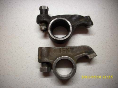

  • Posts: 4403
Re: adjustable rockers.
« Reply #8 on: July 06, 2014, 09:31:43 AM »
I think there is more than one version of Iskys.  Mine were clearly marked 1.5:1 and ran a ball/ball pushrod.  Adjuster came up from the bottom
Like these (not mine)
I have never used a 1.76:1 Isky, I do like those Graham ones though
