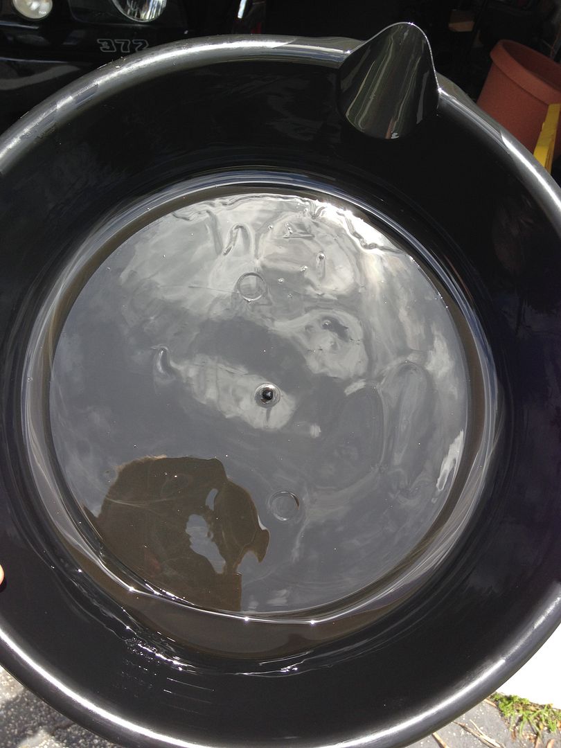

Drained the oil.  First great sign.... No coolant in the oil.
Second good sign, still pretty clear....
Third, no metal that i could initally see
Wanting to reuse this same oil, i got a clean plastic container and a clean funnel and slowly added the oil back looking for metal. The great news is, no metal!  Not until the last ounce did I see like maybe 10 specs of metal .... And im talking like tiny(like a piece of sand or smaller).

« Reply #710 on: May 11, 2015, 01:56:06 PM »
I wouldn't reuse that oil with how rich the engine has been running.
You also need to cut the filter open to see what's really going on.
On the last pic, is that debris that you're focusing on?
« Last Edit: May 11, 2015, 01:57:55 PM by blykins »

« Reply #711 on: May 11, 2015, 02:01:38 PM »
Hard to see in the last photo, but there are like 10 tiny specs of metal.  This was all that I found in the entire 8 quarts.
Also, oil doesn't smell like fuel at all.  Smells just like brand new oil out of the container
« Last Edit: May 11, 2015, 02:03:11 PM by cobracammer »

« Reply #712 on: May 11, 2015, 02:03:39 PM »
You'll generally just see a metallic sheen in some of the oil on a break-in.  The filter should catch all the big stuff.  You may want to cut your filter open and take a peek.

« Reply #714 on: May 11, 2015, 02:20:44 PM »
Again, I'm not trying to come across as negative, but if I were to see discernible pieces of metal in the drain oil, I would be cutting the filter open.  The filter should catch everything and it's normal to get bits of sealant, or aluminum that has shaken off the heads/block, etc., but you shouldn't be getting discernible pieces of metal in the oil that you drain out.

« Reply #715 on: May 11, 2015, 02:27:41 PM »
I will cut open the filter shortly.  The engine only ran for about 30 minutes and at no time was it over 1200 RPM (So technically not a good break in).
The "Pieces" of metal are quite literally like specs of sand.  unless you stick your face in the pan, you can almost not see them.
I would replace the filter anyway, so cutting this one up should be interesting.  I guess I was just excited also because I have magnetic drain plugs, and there was very little on those too!
Will probably want to cut open the filter the 2nd time I run the engine too....  to see if things are better, worse, or the same.
