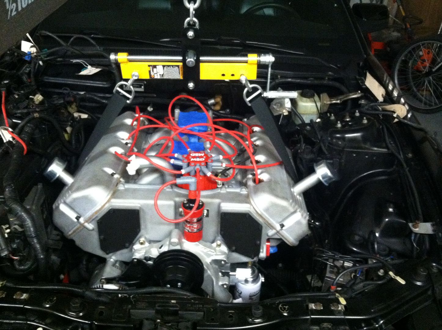

EFI anyone????  Lol. Looks big, but just clears the stock hood!  Sorry for the 1st pictures "Fuzziness", but I take these photos with my phone.  Anyway, not in these pictures are the aircleaners hold down knobs.  They also fit under the stock hood, but touch the thermal matting attached to the underside of the hood.  Also, the aircleaner is a bit long, so I had to take a cresent shape out of the cowl lip (plastic and thin metal).  Only about 1 inch so the cleaner would not interfere.  Also when I bolt up the transmission, the engine will rotate forward slightly too, so I should be set with clearance!

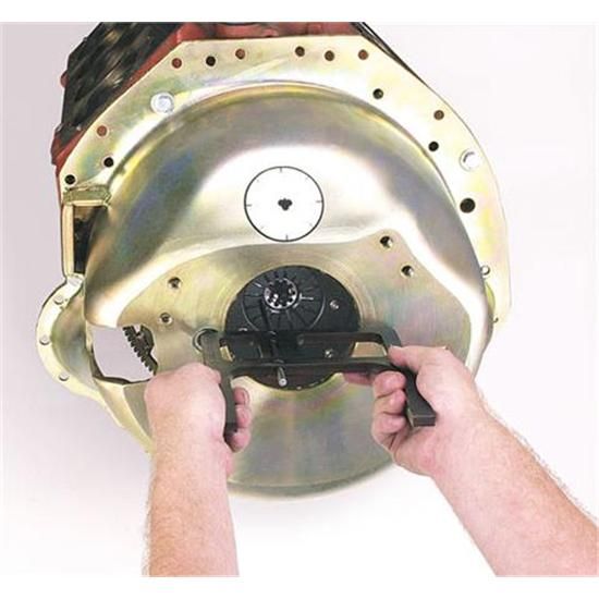

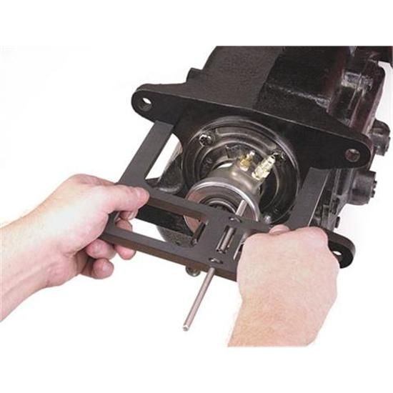

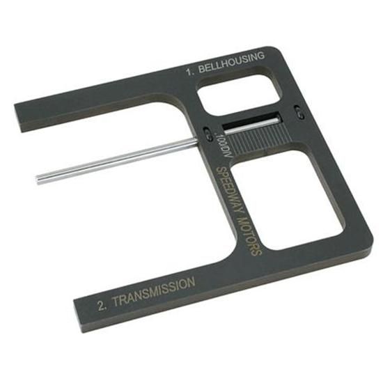

In order to measure for the throw out bearing clearance, there were a few measurements that were needed (there are a few websites, including RAM clutches, that show you which measurements are needed.  After reading them, I almost (ALMOST) pooped a little.  One of the measurements was from the block surface to the mounting surface of the crankshaft  (where the flywheel bolts on)....  Well after getting everything including the bell housing torqued to spec...  I thought I was going to have to crawl under the car and pull everything off again to measure.  Fortunately, while doing a little internet sleuthing, I came across Speedwaymotors tool section and found a nifty little gadget.  I attached a picture below, but its as simple as measuring down from the back of the bell housing, and then measuring from the trans to the surface of the bearing (compressed).....  Should arrive by Friday.  Also, USPS says the Ram throw out bearing kit is arriving today and should be there when I get home  !

OK boys!  Back from vacation and ready to get moving.  The Friday before I left, I got my throw out bearing fitment tool from speedway motorsports (Pictured above) as well as the RAM throw out bearing kit with all of the accessories that should make this a 1 stop shopping kind of install.  Car is back up on the 12 ton jack stands, and the transmission is out of the box (Cant wait to throw out that huge box and wooden pallet its sitting on.... space sucker in a 2 car garage.
