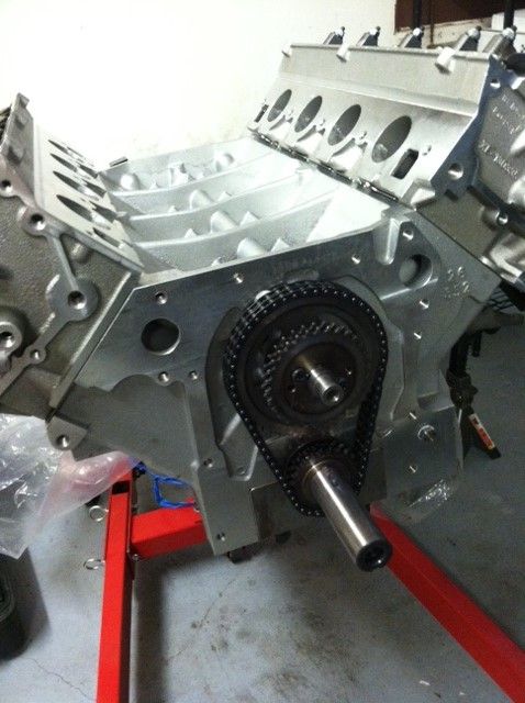

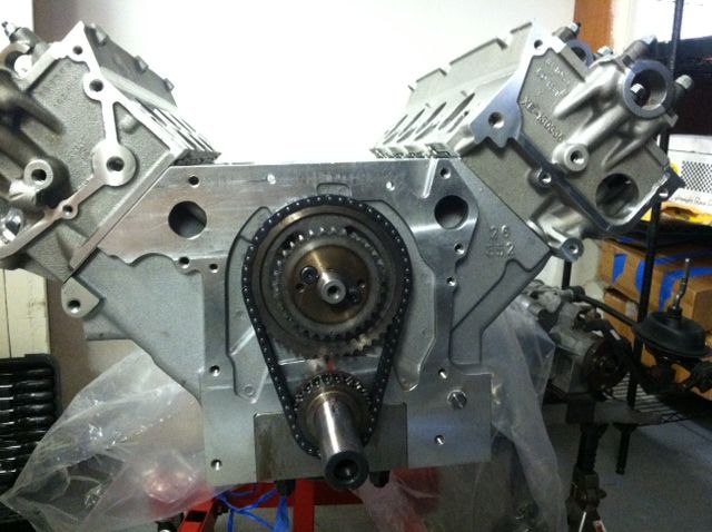

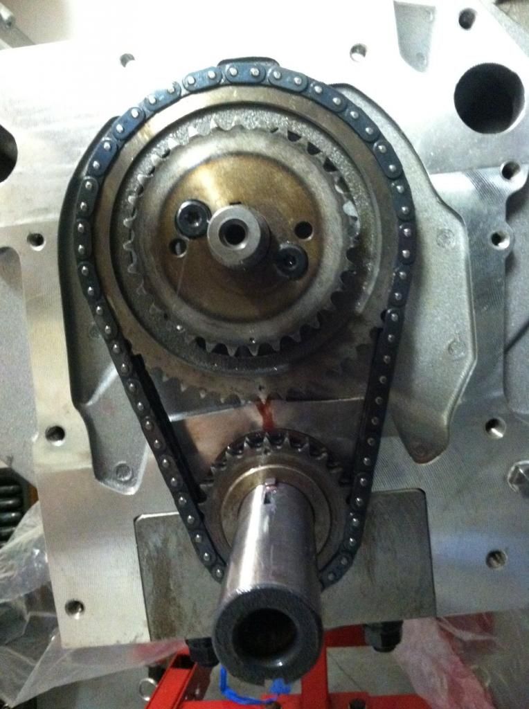

HAHAHA  OK.  2 days in, I got the small stub cam gear all set up with the 1/2" steel bar welded on, Milled flat, drilled and counter bored for the head of the bolt.  Got both Gears pressed onto the stub cam and drilled out the larger gear for the threads on the bolts.  I slathered the both threads with red Loctite, and inserted.  I got each bolt head about half way into the gear (meaning that I counter bored about half the height of the bolt head.  Pictures below.  From the look of it, the bolts are recessed far enough that they wont touch the bearing that goes in the front cover (end of the stub cam goes through).  Want to throw these pictures up on here before I put the crank gear and chain on and install on the front of the block....   8)

Looks good.  Before you install the stub cam, put the bearing in the front cover and then fit the stub cam in from behind, to make sure that the bolts don't hit the cover.  There's isn't a whole lot of clearance there.  If the stub cam bottoms against the bearing, and you can see the snap ring groove from the front of the cover, you should be good to go.

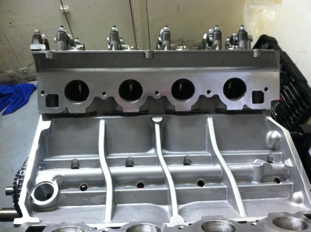

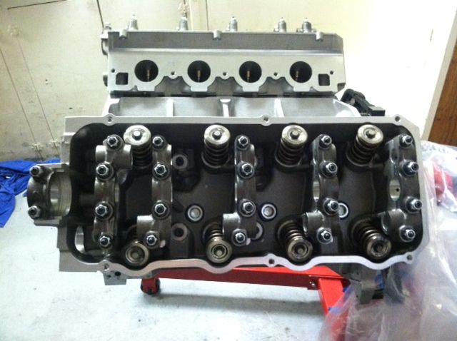

Hey Jay.  Thanks.  After you said that, I went back in to the garage and pulled the stub cam assembly out so the 2nd journal on the stub cam was resting on the # 1 cam bearing (So that it was sticking way out the front so that I could test fit the face plate.  I pressed the bearing into the face plate, and put it all the way onto the stub cam where I could see the snap ring groove out the front.  I spun the face plate all the way around a few times, and could hear a slight scraping.  Pulled off the face plate and saw that it was slightly touching one of the bolts.  I tightened that bolt a little and put the face plate back on.  Spun it around about 3 revolutions and no touch!  Nice!!
Once I had that all buttoned up, I pulled the heads out of storage.  I wiped the combustion chamber down (as they were a little oily from the motor oil I rubbed them down with before I sealed them for storage 3 years ago.  got the head studs and head dowels on and placed the head gaskets on.  Both heads have head studs and they were torqued in 3 increments (70-90-110) in the order specified in the 427 Cammer maintenance shop manual  (from the center out).  Once the heads were on and torqued down, I pulled the gaskets out of their box.
With this, I wanted to be sure of a solid seal, so I laid the small gaskets out that go on each head, the 2 gaskets that go where the water pump goes, and the gasket that goes around the timing chain.  After matching them up to their place for installlation (which side needs sealant), I put a bead all the way around the gaskets and used my finger to basically coat the entire gasket with a layer.  I figured this would be safer than putting a small bead all the way around.  I stuck them to the front of the block and heads, and then coated the fronts of the gaskets in the same manner.  once this was done, I sandwiched them with the backing plate.  Much like Jay said during his built, getting the bolts ready so you have all the right bolts ready to hold the backing plate tight against the gaskets was key.  once I had them all tightened up, I took my finger and cleaned all the areas where the sealant squished out.  Before I finished for the night, I remembered that the bolt next to the bottom bolt on the passenger side water pump needed to be coated with sealant and sealant under the washer and alll around it (because it goes into the water jacket).  I am going to be setting the timing and then taking the cover plate back off, so I will not be installing the second set of gaskets until after the timing is set.  See below pictures!  FINALLY starting to look like a Cammer engine@!  Not sure if you can see it on these pictures, but when I had the heads done up at Keith Craft, he did a slight port job for me.  Smoothed out the intake ports "casting texture" for better air flow.
« Last Edit: August 04, 2014, 12:34:37 PM by cobracammer »

OK Last night, nothing big, but got the bearing pressed onto the Fuel pump gear and then the bearing stand.  Then got the tensioner, bearing and pin all pressed into place.  I loosened the bolts only where these items will be located and went to install, but realized that the bolts I have are not long enough!!!  They are both 1/2-13 X 3", but it looks like I will need a 4" bolt (or 3.5" at the least).  I searched home depot, lowes and ACE, and no one has them, so I ordered the 4" bolts from ebay and as soon as they get here I can bolt them down.
On a side note, the backing plate has been sitting now (compressed ) for 2 days and seems solid as a rock!  I do not believe there will be any leaks nor will it ever come loose!  As soon as I get the right length bolts, I will be installing the cams, Cam gears and large chain!  This is fun.  And like everyone has been saying from the beginning, going slow is the best way to do this engine.  I forgot to mention it earlier, but I did remember to put a small piece of Gasket material on the 2 areas indicated on Jays build.  They don't seal anything, but the gaskets will ensure the backing plate stays flat against the block.  You can actually see one of these places on the above picture on the bottom right corner.

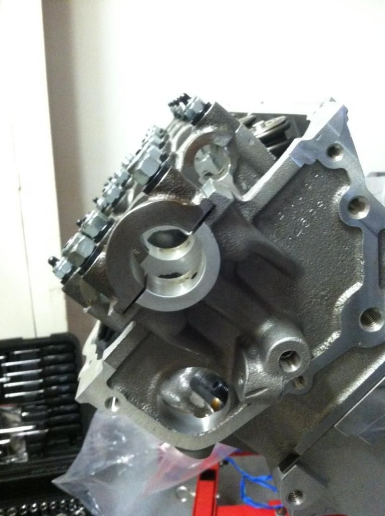

« Reply #178 on: August 05, 2014, 09:25:03 AM »
I was looking at your photos and it looks to me like you gave the front cam cap on the heads on backwards.  The wider flange should face to the back of the engine, not the front.  Have you installed a cam yet to check that it spins properly in the head? I doubt it would turn with the front cap installed that way...

« Reply #179 on: August 05, 2014, 09:28:45 AM »
HAHAHA  Its funny you caught that!  When I was leaving Keith Crafts shop years ago, I asked him about that as it looked backwards.  He said told me that it was the correct way, but it looked weird to me.  Last night it bothered me so much I ran in there and turned it around.  The pictures above are from the day before  LOL  Good catch as usual!  8)
