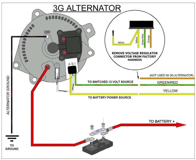

Found this diagram on the Factory five website.  What I can say is that I do not have a ground wire attached to the back of the alternator.  Would it have been possible that the original 6G alternator wouldn't have had a ground wire, but the 3G alternators need one?  I cant seem to find a clear answer to that online (and oddly, some of the wiring diagrams for 3G alternators don't show a ground wire either.
Thoughts?
« Last Edit: August 22, 2016, 02:33:13 PM by cobracammer »
Jason
« Reply #1609 on: August 22, 2016, 03:54:25 PM »
That diagram looks like how I've got mine wired.  I don't use the ground wire since the engine is grounded, and the stud for the ground wire just goes right to the case of the alternator.  As long as the engine is well grounded, you shouldn't need to hook that wire up.  I hooked the yellow wire right to the big stud on the back of the alternator that the large cable also has to go to.  Then, ignition switch power to the green wire, which energizes the voltage regulator.

Ok.  Crawled under the car tonight.  In checking out the alternator, it was basically wired correctly..... "Basically".  The yellow wire was already looped back up to the power stud.  The white wire was plugged in correctly ( as shown in the picture above).  Finally, the pigtail connected the green "trigger" wire plugged into the oem harness which is linked to the computer.  I disconnected the pigtail, and ran a new wire from the infamous mini buss bar on the passenger side kick panel.
