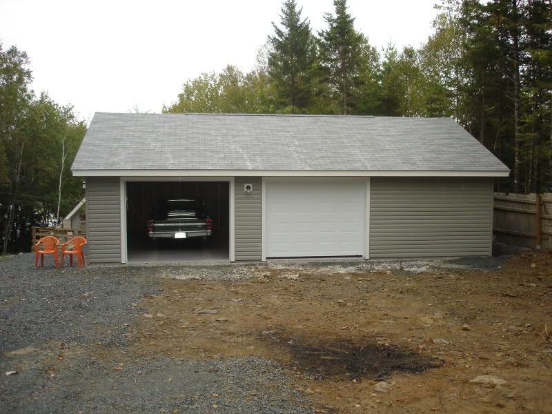

I need to paint my Mustang.  It's starting to get a little rough looking.
I built a new shed this year and plan on doing the Stang in it during the next little while.
I know the Stang is not there, she's still in the old wood shed back at the old place.
I'm too embarrassed to take a pic of it. It's not pruddy.

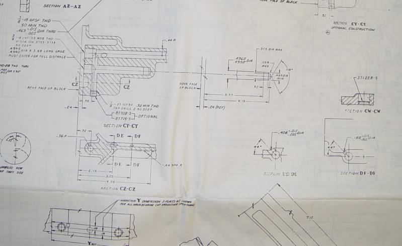

This is what the relief port looks like, but does not seem to be an issue I have heard from anyone using a Genesis block.
Not to start an arguement but more and bigger passages do not need more pressure or volume. Oil pump requirements are still driven by bearing clearances throughout the engine.
Side oiler sends the oil to the crank first and does a better job of it though cannot complain about how the bearings have lasted in my top oiler once I got the clearances right.

Thanks Mario.
I have that drawing and have been staring at it for a bit. lol
Everything I have read on this says that a HP pump @ about 100 to 110 psi is what the factory used in the 427.
I was looking for a pic of the vent port inside the block.

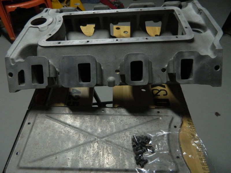

Picked up another intake. Ya that's what I need another FE intake.  ::)
Looks to be in great condition. Fair price to boot.
Re: My Geny.
« Reply #11 on: January 06, 2012, 09:47:35 PM »
Nice, Howie!  Looks like an original MR tunnel wedge.  If you don't mind my asking, what did you have to pay for it?

« Reply #13 on: January 06, 2012, 11:12:48 PM »
No problem Jay.
I paid 1000 loonies.
I actually used your book to make sure it was a real Ford one and showed the guy
all the info in the book. Even the $1200 price mark you said.
We were both happy with the deal.
Kinda bit into my crank fund, but it was just too kool to pass on.
