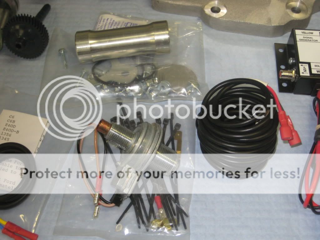

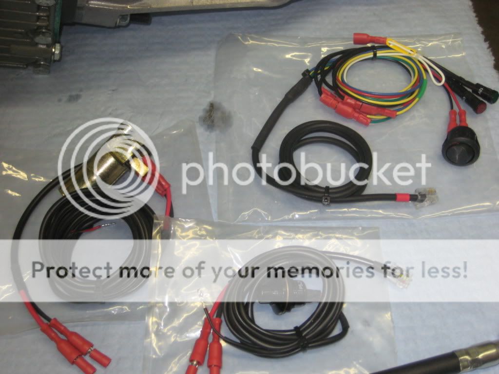

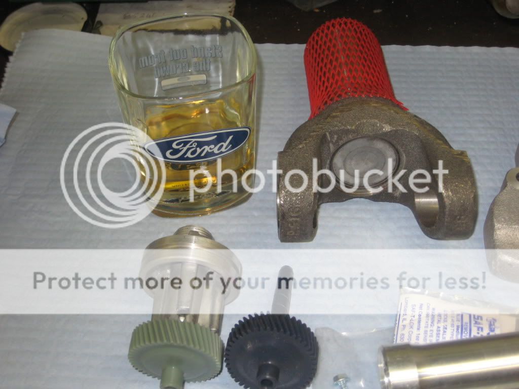

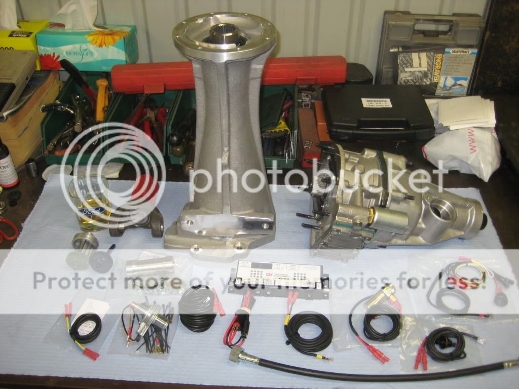

Here is a pic of the entire kit (uncle Jack's magic elixer was an optional extra :yummy: )

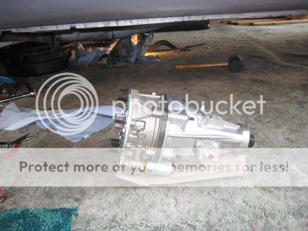

Overdrive unit itself. Uses planetry system and internal pump like an auto trans.
Control unit. Can be mounted hidden away as access is not required.
Supplied with new yoke and speedo drive uses TH400 plastic gears. They supply a gear to suit your rear end and tyre size. They also threw in another freebie gear for a smaller tyre size.
Normally supplied with an auto is the floor mounted switch on the left but they also threw in the shifter button in case I want to use that. Also in picture is the rocker switch with two lights connected to switch between modes. This is to be dash mounted.
Seen in this pic is the speed sensor and Ford speedo cable adaptor. You keep your original speedo cable.

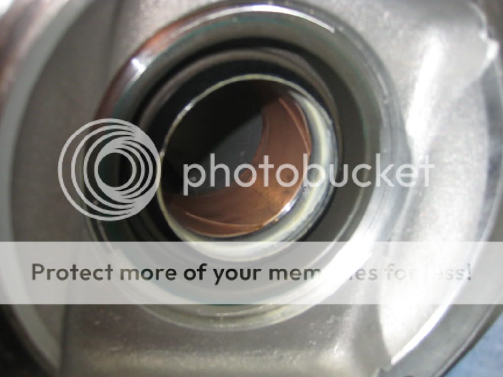

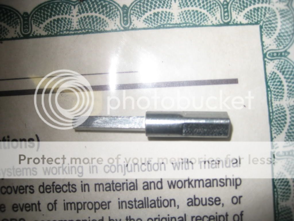

First issue is the adaptor. The coupler slides into the bush nicely until it reaches about 040" from exiting the bush on the inside. It then locks up pretty tight, will no longer rotate and takes much force to push through. I will phone them and seek a response but the inner section of the bush will need work as it is just way too tight.
Coupler inserted until it nips up.
Bush
Manual is ordinary and looks like it was done by a computer novice 15 years ago (probably was). They should do better.

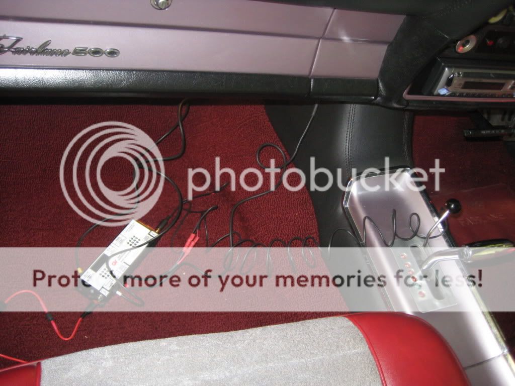

As I am not doing the mechanical side just yet I thought I would find a place to mount the swith and indicator lights. Didn't really want to put any holes in the dash or console and I am not that fond of tacked on plates.
I have also never liked the factory clocks, I bet they never even worked that well when new! Most aftermarket stereos have clocks anyway.
Friday night I pulled out a spare clock, removed the facia and cut the back off it. I then machined up a new facia from aluminium and cut the holes to suit.
I then painted and fitted it to the modified clock housing.
New "clock" assembled in dash and is a totally reversible modification if the lights annoy me.

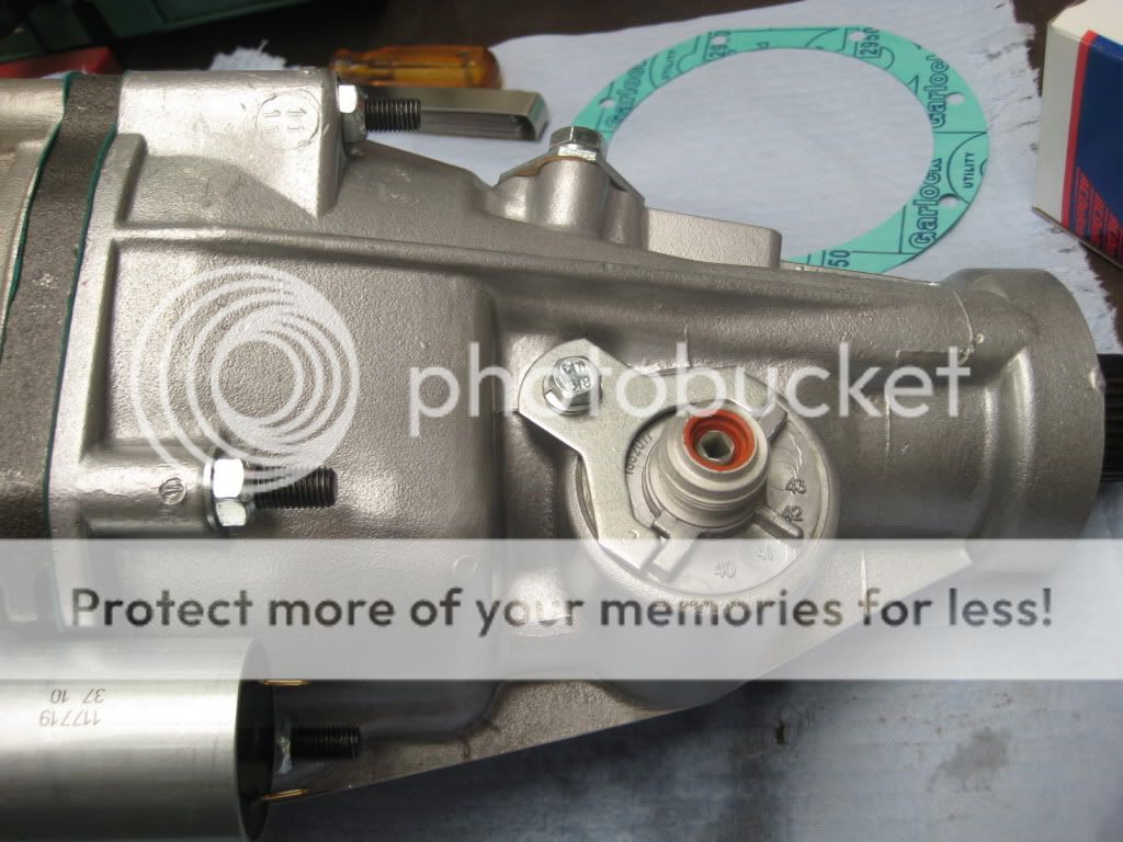

Cleaned up the gasket surfaces with Prepsol and installed gasket dry as per instructions.
Adaptor next to original housing.

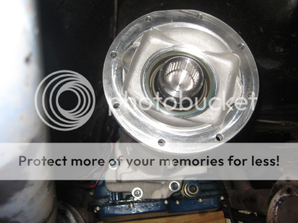

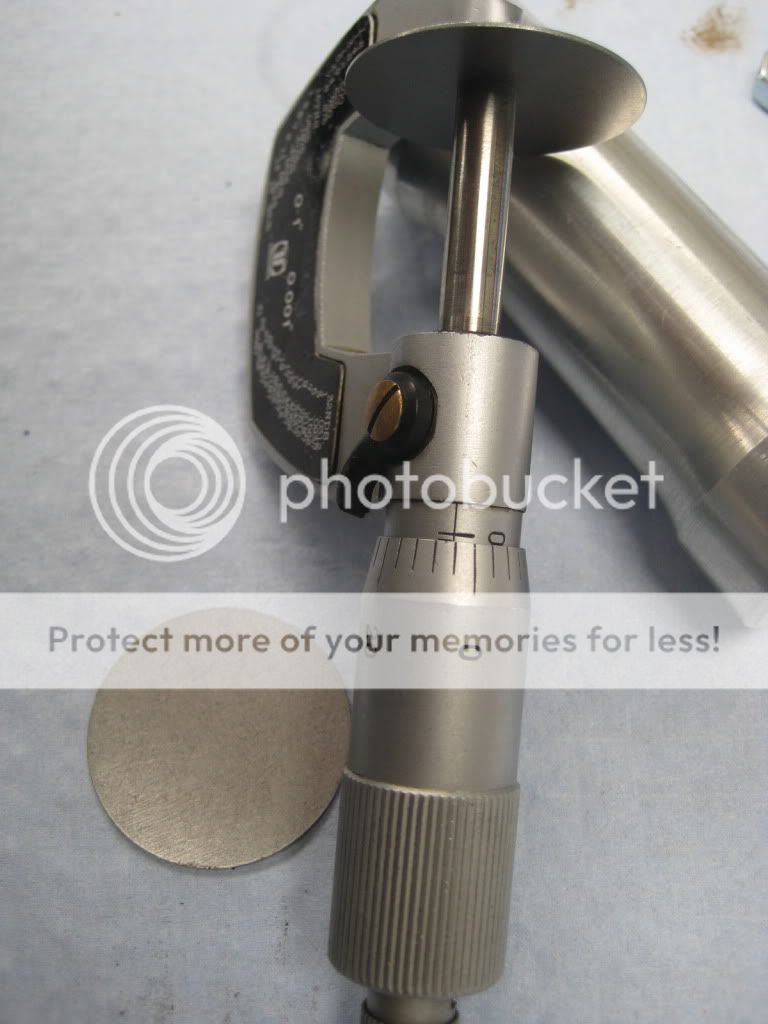

Next thing to do is install the coupler in the troublesome bush and check end float. You have to lay a straight edge across the face of the adaptor and measure back to the fully seated coupler and adjust end play. In one of their instructions it says to adjust to 0-.015" and in another it says .005-.035". They supply shims and you stack them in the coupler and replace on the output shaft to acheive desired result. All supplied shims are .024 so I don't know how you are supposed to get it spot on. Anyway mine checked out ok at .015 with 4 shims.
Supplied shims at .024
Coupler installed

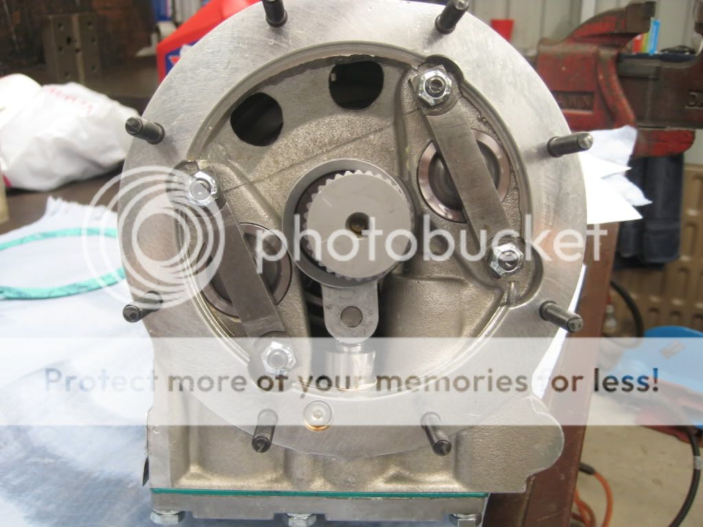

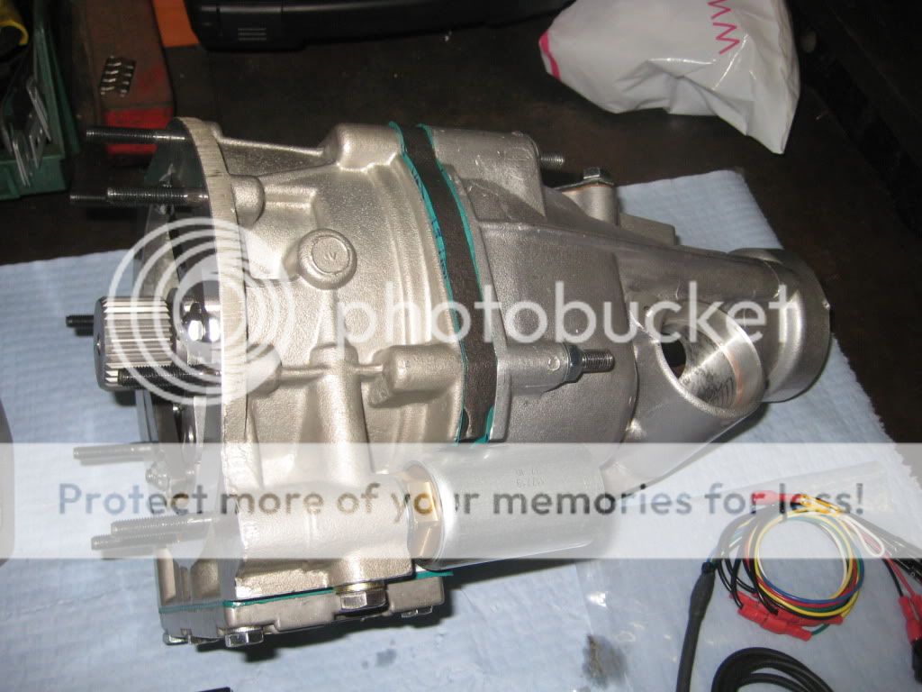

Here is a pic showing the input side of the overdrive unit. Pump eccentric is clearly visible.

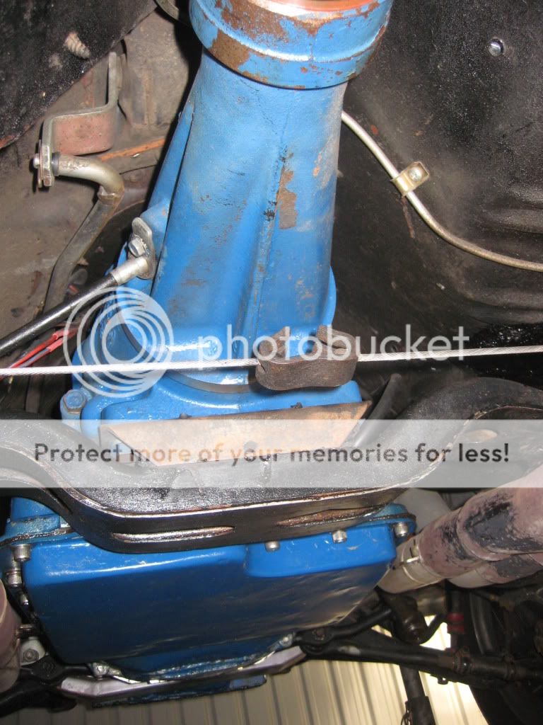

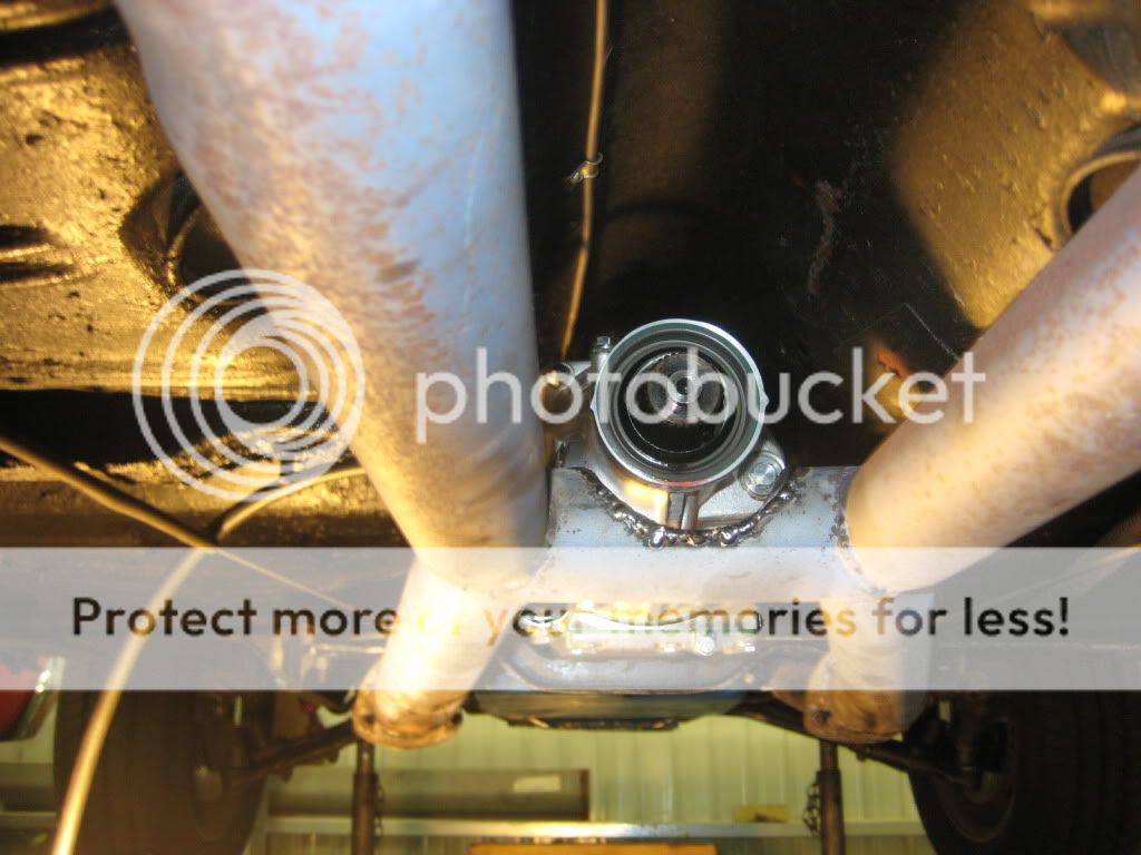

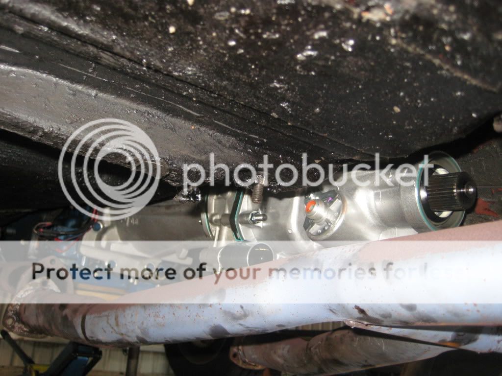

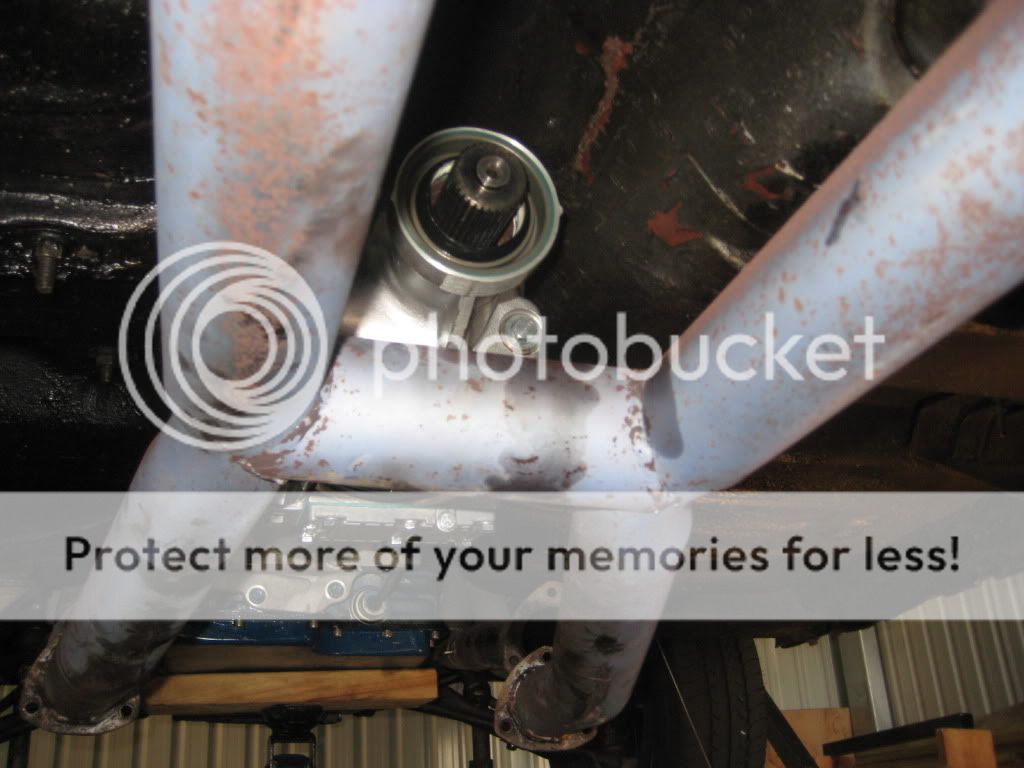

I then jacked the trans up until it all hit the floor and went about reinstalling the crossmember. Let the fun begin. The crossmember has zero hope of bolting up to its original position. The interference with the floor means that the crossmember is sitting about 15-20mm lower than where it was. For now I have bolted it up with spacers. when the jack was let off the trans it eased on the mount and dropped off the floor about 10mm, about where I want it. At least it will allow me to measure the driveshaft length. Once I have the driveshaft in place I will measure the angles and if not too severe I will modify the crossmember to hold it in the lower position. I will also have to drop the exhaust right off and modify the balance pipe as it hits the overdrive unit and will not bolt back up.
H pipe interference.
Another pic of installed unit looking back.
Tailshaft ready to go out.

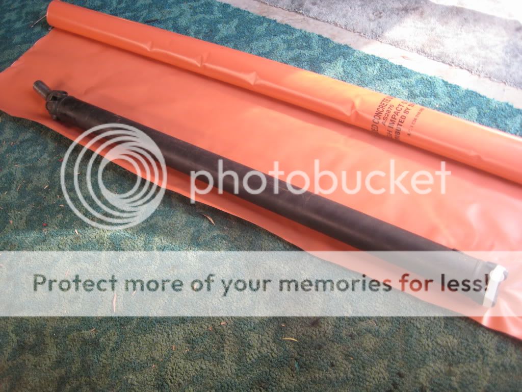

Gear Vendors told me it would bolt straight in with no trans tunnel interference although I was was warned by others on another forum I would need a hammer. I suppose I shouldn't complain about the fit as nothing is standard or original on this car. But this is definately not a straight forward installation.
Car will need a 1010mm tailshaft. From centre of slip yoke uni to centre of rear uni. The more expensive and harder to fit "shorty" option is starting to look good.

I dropped the exhaust off and decided to modify the H pipe for clearence rather than cut it out. The only peice of pipe I had with a suitable radius was stainless so not having any gas for my mig at the moment some high nickel electrodes were in order. It doesn't look real neat but with the prospect of exhaust modifications to come I wasn't too worried.
Here is the peice welded in and fitted up.

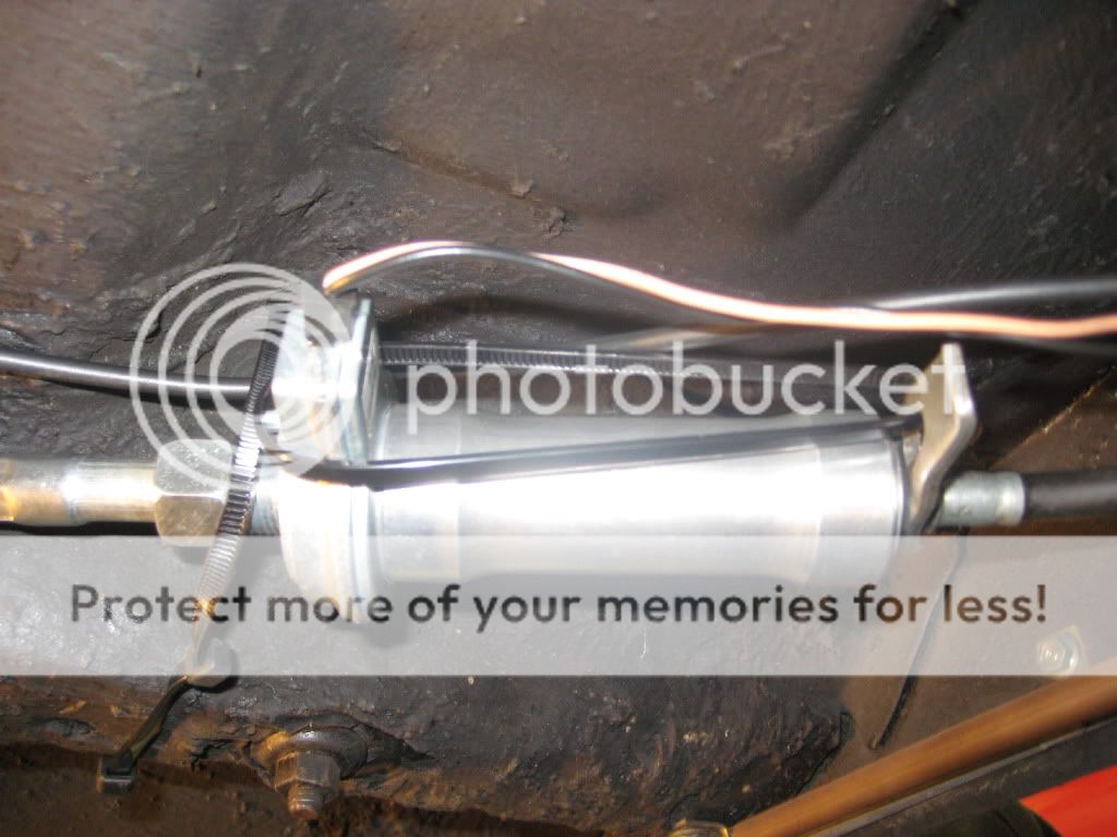

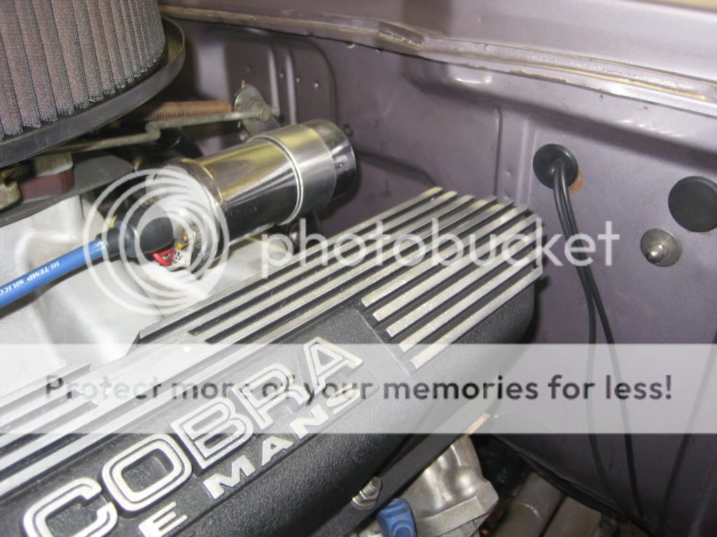

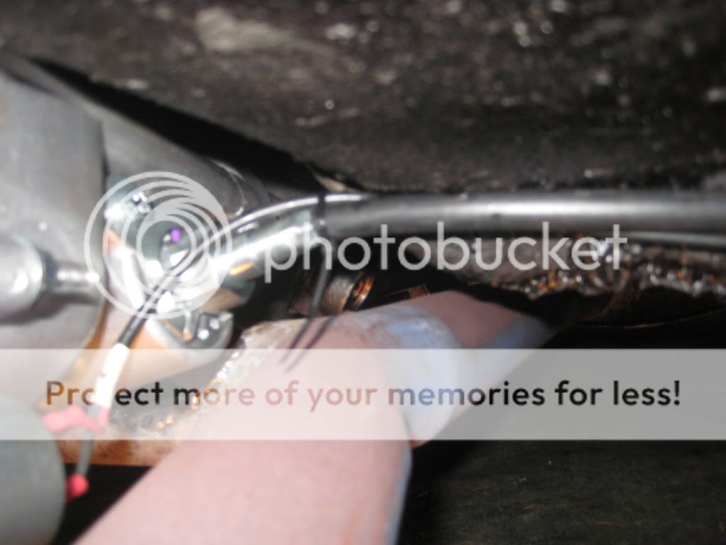

Next thing I did was fit the short speedo cable to the OD unit and then fit the electrical speed sensor thingy (forgot what its called) and the Ford cable adaptor. Fit of the original speedo cable is strange as it just pushes in the cylindrical adaptor with the only thing retaining it a 'click' fit of the o-ring inside a groove. I wasn't too keen on this so I put a zip tie on it too. I have also just zip tied all this stuff up and out of the way and will neaten it all up later.
Wasn't all plain sailing though. Initially the original cable would not push in far enough to engage the o-ring groove. Small drive adaptor pin below required shortening by about .080".
I also dropped the unit back off the floor and got up there with some bars and stuff and tried to ease the floor where required. With this and the moving of a brake line I have been able to get the crossmember closer to it's original (well for this car) position. I have two heavy 5mm washers between the crossmember and the chassis. With these in place one side of the OD unit is touching the floor and the other is about (3mm) off.
You can see the washer installed here.

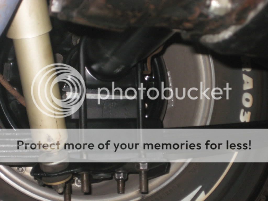

Well...I measured my driveline angles with car in the air as it was during the install. The important thing is to have the car supported under the diff so it sits at approximate ride height. Doesn't really matter what angle the car is on.
After much research on driveline angles (and there is plenty of misinformation and lack of understanding out there) these are the rules I am playing by, There are only 2:
1) The output shaft of trans and input shaft of diff (yoke) should be parallel to within 1 to 1/2 a degree with the diff pinion being down that 1/2 to 1. Diff pinion angle is all a compromise. With a leaf sprung car the more hp and the more strip time it sees the more angle down on the diff pinion. As this is a street car I will shoot for the 1/2 to 1 degree down. This keeps the operating angles of front and rear unis very close to equal.
2) These shafts should be brought to within that tolerance in such a way as to try and ensure that the operating angle of the unis does not exceed 3 degrees. This is for a hottie. Standard passanger cars & 4wd's etc can tolerate angles up to 7, but angles within 1/2 to 3 degress are more desirable. Operating angles of 0 degrees are a no no.
End of story and no debate will be entered into. There is enough debate out there on other forums and beleive me I think I have read it all!
So here is a pic of driveline angles as measured with those 5mm spacers under the crossmember to 'clear' floor.
This means that either the output shaft or diff pinion has to come up about 4 degrees to make the angles parallel. If I take the pinion up 4 degrees then the operating angles of the unis become large (7 degrees). So obviously the desirable thing is to lift the output shaft, but the floor is in the way. Wanting to take it for a test drive without it shaking like a dog passing you know whats I made up some temporary 3 degree wedges to get the angles close.

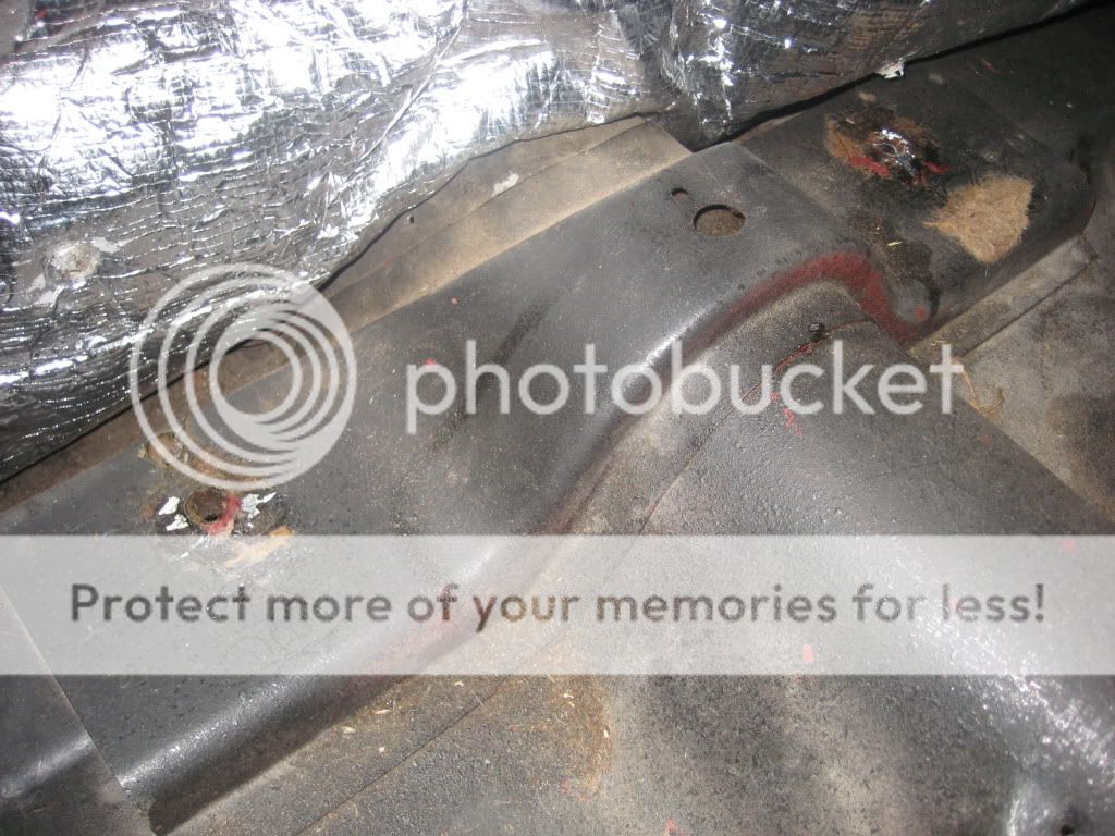

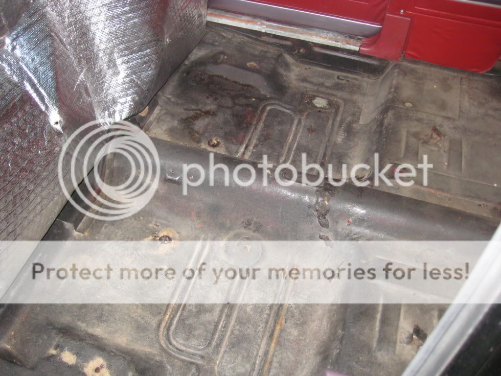

I got home and am very keen to get the floor sorted and the unit up so I can drive it with confidence and get stuck into it. So out came the interior.
Unfortunately Where the tunnel need altering is right under a brace. Still thinking about this one.

Well...I finished the floor modifications but unfortunately the Minister for War deleted my photos off the camera and I now have the interior back in! I removed the brace and cut a slit down the the top of the tunnel about 8". Then cut perpendicular at each end down to near floor level. Opened up the tunnel and welded a strip back in down the top about 1-1/2" wide. Then patched up the rest. Luckily my console still just fits. I also had to pull the floor up where the speedo cable go's.
Measuring my new drive angles I had the trans at 5.5 deg and the diff at 3 deg (without temporary wedge plates). So I removed my temporary wedge plates and angle milled my lowering blocks 1 deg. This means my pinion is down 1.5 deg. I thought I would see how this go's as I can always cut some more angle.
