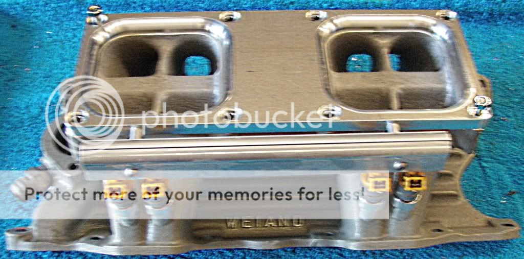

I've posted a link showing the stock interior of a BBC plenum (converted to EFI too) and I'll admit to being only familiar with tunnel rams run on BBC/SBC engines (hey, it was long ago..LOL!). But in both cases, the paired intake runners are literally as close as Jay's design and, of course, they also have 2 cylinders that fire in consecutive order w/o any real issues. Yes, the BBC cam makers did invent so to speak the swapped Chevy firing order common now on all-out race BBC and SBC's too for the same reason....better cylinder filling. Yet, the hp gains are alleged to be minimal and some folks have told me it's only on the order of 5-7 hp in at least 600hp engines. Good article too on the how/why although I have zero idea on how many hp a Reher-Morrison Pro Stock engine in the 1,300+ range may gain.

http://media.photobucket.com/image/chevy%20rat,%20tunnel%20ram,%20interior/mrn2obelvedere/SideViewIntakeShowingInjectorsandRa.jpg

Big difference in the angle of the paired ports, the entrance to the ports on the tunnel ram are flat not facing each other like Jays setup is. The tunnel ram if the throttle bodies bolt on what is show is virtually an individual runner deal, just enough room for some vacumn balance.

But, I couldn't find quickly some other interior shots of older SBC/BBC tunnel rams made by Weiand and Edel-B that do have the lower edges much closer together, ala' Jay's, than the one I selected and posted.
After some searching, here's a link to what I was thinking about, the old SBC TR-1 from Edel-B that many ran in the days of yore: http://www.gasserhotrods.com/forum/showthread.php?349-Tunnel-Ram-Question
Anyway, it'll be good to hear from Barry's contact if this does actually pose a problem....I'm sure we all hope not but it remains to be seen. If Jay does end up doing two different plenums, it should prove the point. The bad news is I do remember the advent of the sheetmetal intake era (mainly Pro Stock 351C's) where lots of racers spent a lot of time and effort shaping up many variants,, only to find they often lost hp! It is an art for sure in not only runner i.d. and length but plenum shape, volume, etc.
