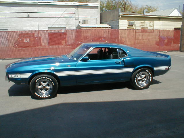

After getting my Shelby clone painted this summer I continued my mad thrash to try to make it to Drag Week.  At first I thought the paint looked great, but after a few weeks of looking at it I began to get the feeling that it wasn't quite what I wanted.  It was close, but not quite right.  The color seemed too light to me.  Not that it doesn't look great, because it does, but as mentioned earlier I'm fussy about this.  I tried to confirm this feeling over the weekend.  When I first got going on this project I did a search on the internet for 69 Shelby's painted Gulfstream Aqua, and found several cars that looked just the way I wanted mine to look.  This weekend I pulled up those pictures, and some pictures of my car, and compared the colors.  See the photos below:

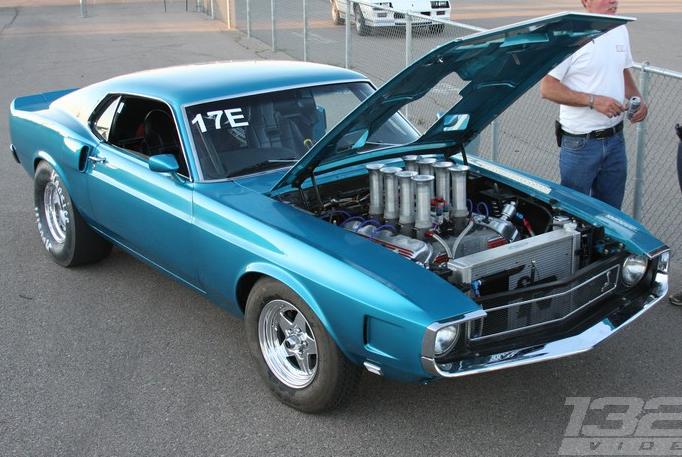

See the difference?  The real Gulfstream Aqua car is darker blue than mine.  This almost ruins the car for me, because its not the color I wanted; I wanted the color shown in the bottom photograph.  I'm seriously considering repainting my car.  The problem, of course, is matching the color I want.  I had taken the paint code to the paint store (a different store than what I used for the Mach 1), but the paint they mixed for me was wrong, at least based on my memory of what Gulfstream Aqua looks like, and the other pictures of cars I found painted that color on the internet.
So here is my question:  Why is this happening?  Is this inaccuracies when the paint is mixed?  I wonder if the paint companies have taken paint codes that are close and combined them to make their jobs easier?  (The reason I mention this is that I had a Ditzler coder for Gulfstream Aqua, but according to the paint store guy the color was no longer available from Ditzler, and he had to get it using their lower cost Omni paint line instead).  Is my only option to spray a test panel and try to adjust the color from there?  That would be a questionable approach to me, although I'm willing to try it.
If I decide to repaint my Shelby clone I'm going to need to make sure the color is right before I spray, and in addition my Mach 1 is approaching the time where it will need paint, and I want to make sure it's right also.  Any comments or suggestions are appreciated.  Thanks, Jay
