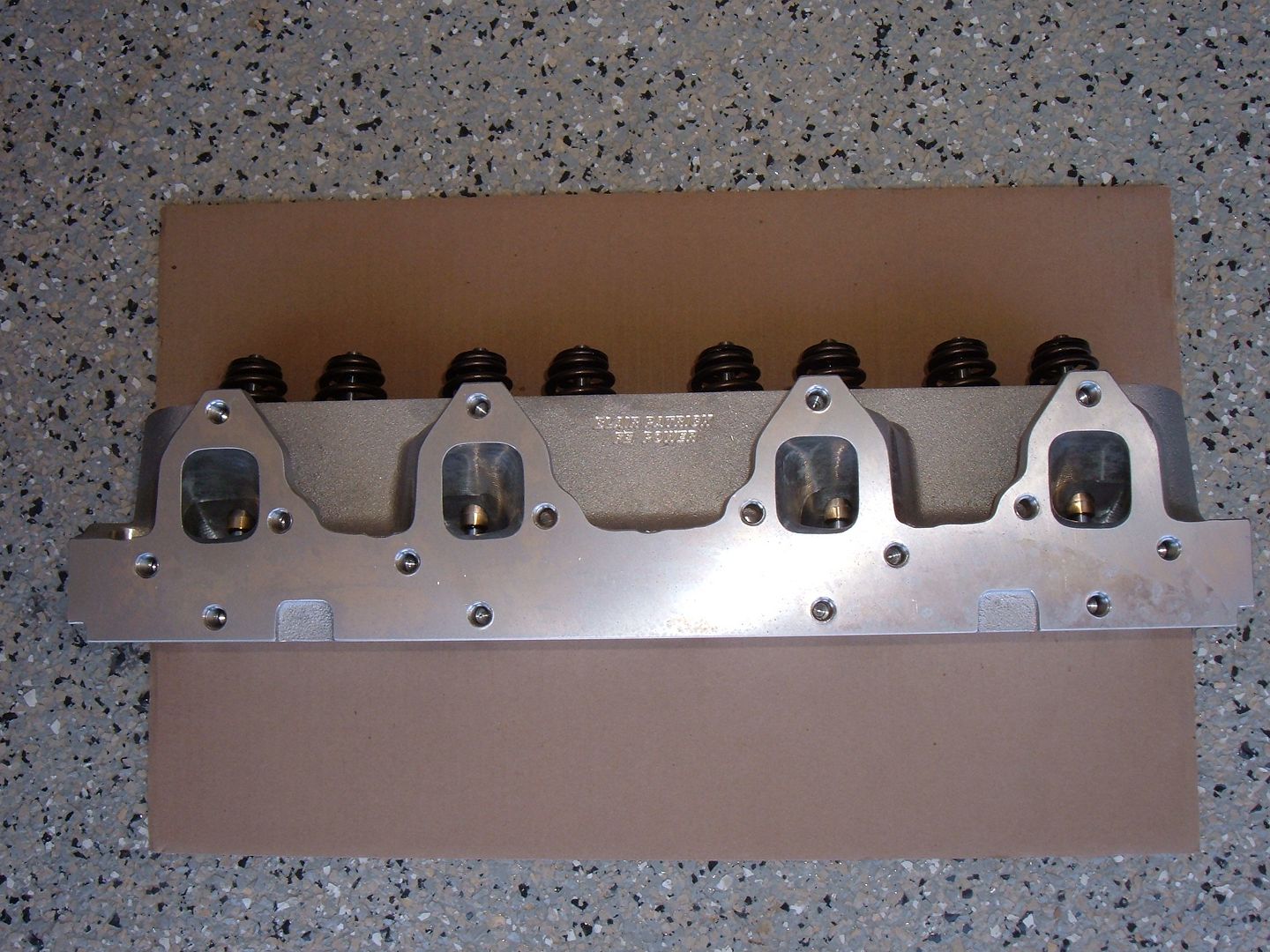

« Reply #34 on: August 08, 2017, 06:02:54 PM »
Now, with the Biggest Ticket Item out of the way, I can start working on the little stuff.
I've had these items show up at my door. Heads are the Street Pro Ports, with stock location exh. Shock Towers made it necessary to go with stock location exh, due to how tight the 2 1/8" adjustable headers were, I couldn't take the chance with having the headers re-flanged, then dealing with fitment issues.
Then I had my "J" Sidewinder matched ported
« Last Edit: April 05, 2018, 10:19:08 PM by 1967 XR7 GT »
Richard
 "Frankly, I'm tired of hearing all the complaints; makes me wonder why I bother hosting this forum."

« Reply #39 on: August 10, 2017, 09:40:11 AM »
Excellent choice on heads. I love mine.
Damn I'm happy to see this thread going again. Get that cat rolling, Richard.

  • Posts: 182
Re: My 427 Build/Match Ported Sidewinder to Blair's Pro Ports
« Reply #40 on: August 11, 2017, 02:19:20 AM »
It took a while to save up for these, and I've also picked up a few small items here and there. Maybe in 3 or 4 months I'll have a 390 together.
