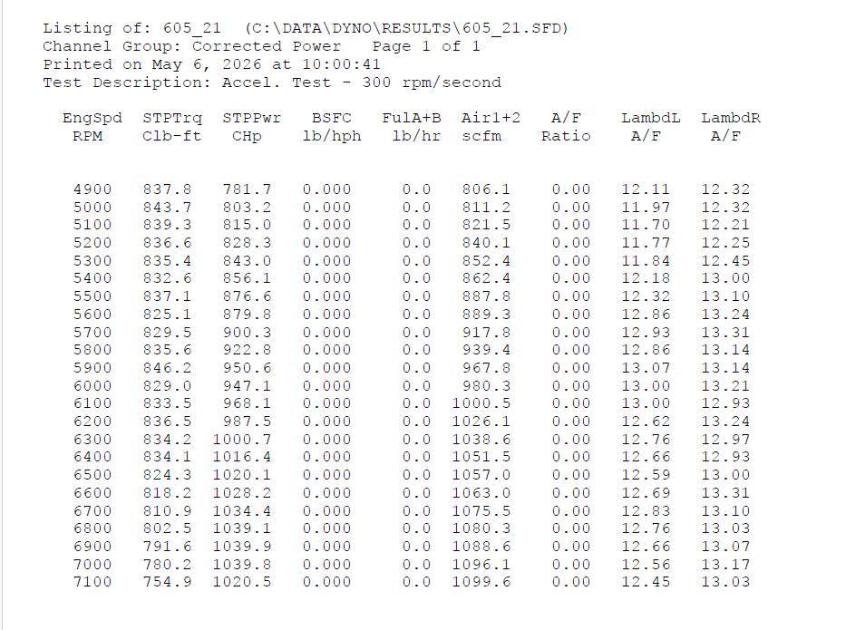

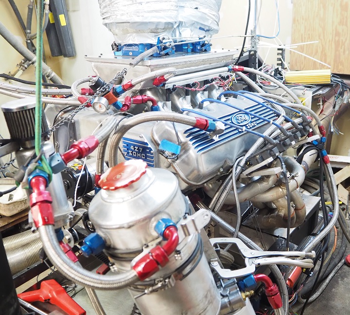

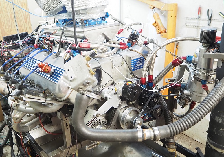

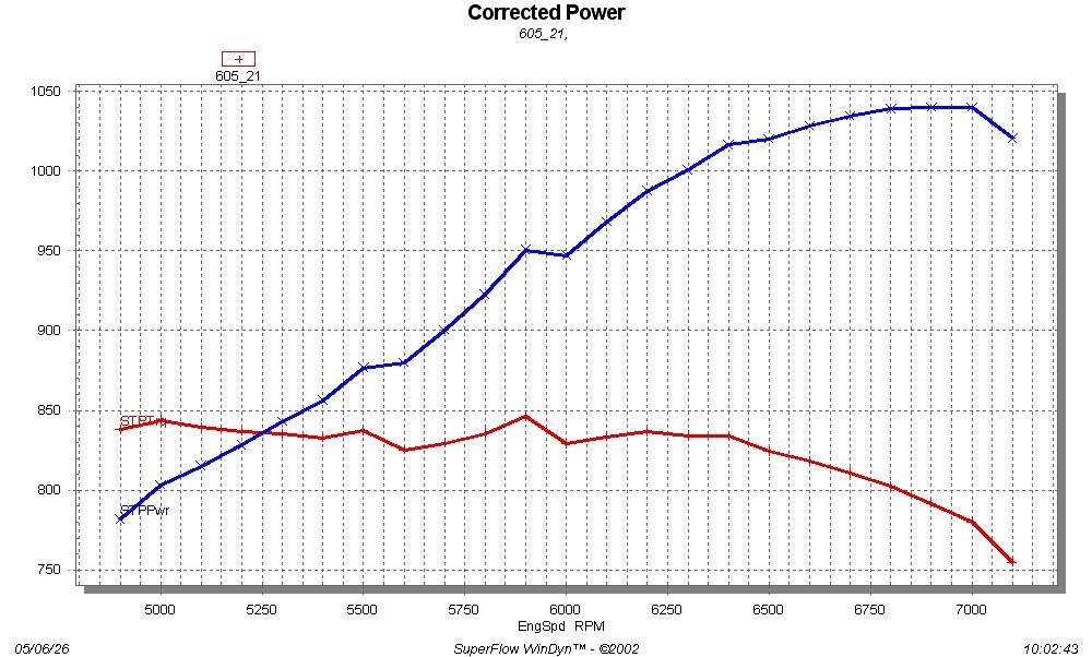

This is a project that has been in the works for about 10 years.  Here's a couple photos of the engine
on the dyno:
A couple pics of the best dyno pulls so far:

It was good to finally get the engine up and running on the dyno.  In 2016 it made 1002 HP, so it has shown a nice
increase in power so far.  I have more dyno work to do on it, with some more tuning I think it might pick up a little
more; we will see.
