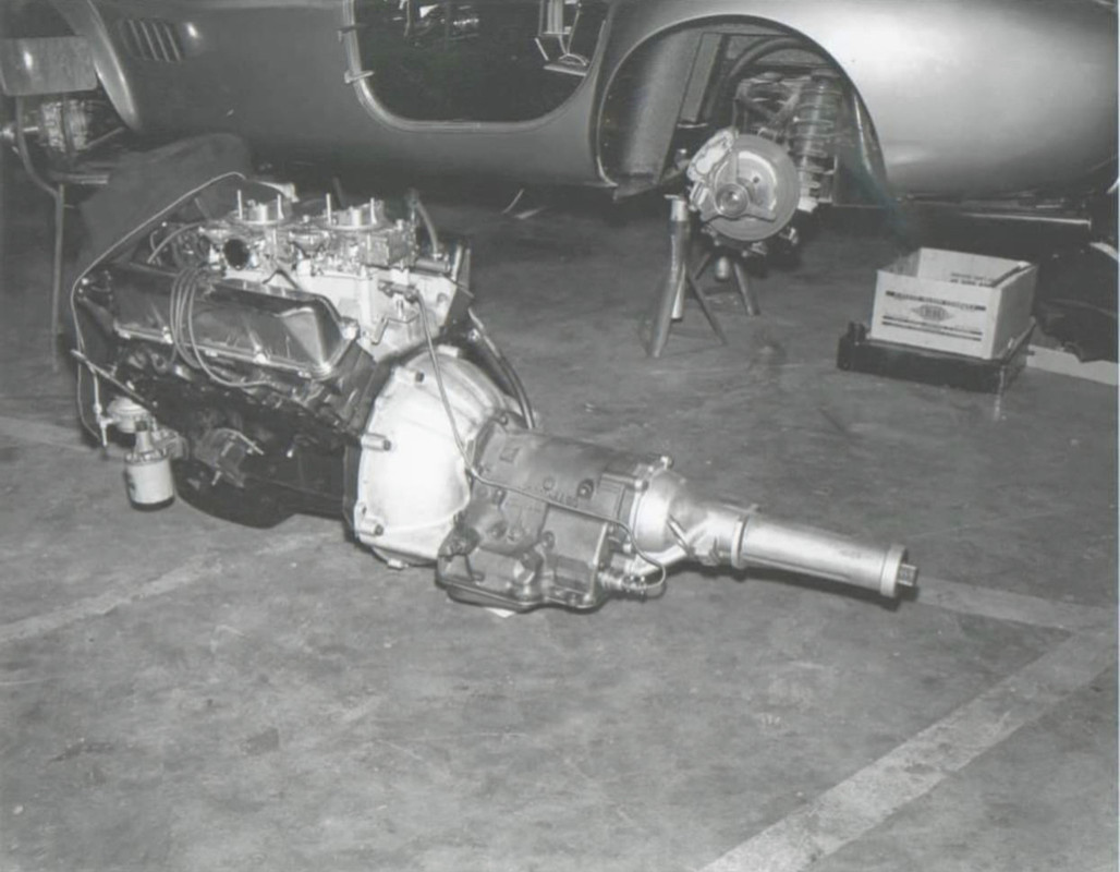

A special version of the large case 430 Lincoln HX cast iron Cruise-O-Matic with a unique HX-7976 convertor housing (bellhousing) to mate it to the FE. Same for the automatic equipped Lightweight Galaxies I believe.
Re: 427 Automatic
« Reply #4 on: December 25, 2024, 08:53:12 PM »
And similar for an automatic equipped 427 Cobra

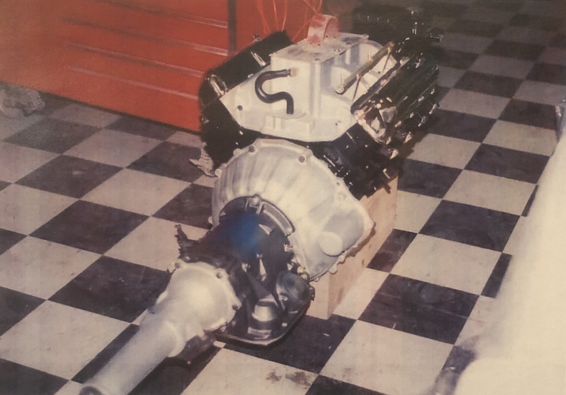

To add a little to this trans, I had a '58 410 MEL and used that large XH case in my '60 Galaxie, in back of a 300 horse, 352.
The early MEL bells bolted to the FE and the 410 version, at lest, had the 31 spline out put shaft. I know that because I had to shorten the MEL drive shaft, to fit my wheel base.
