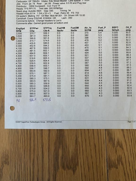

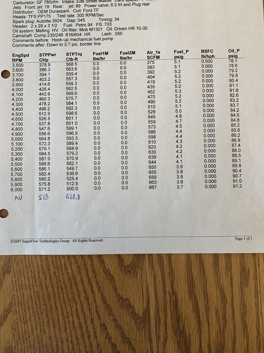

Dyno headers on the first sheet, Hooker 6114 on the second.  Couldn't get these files to rotate properly, but you can still read them.  Looks like the engine prefers a smaller tube header for torque, and also for average power and average torque.  Not a big difference though - Jay

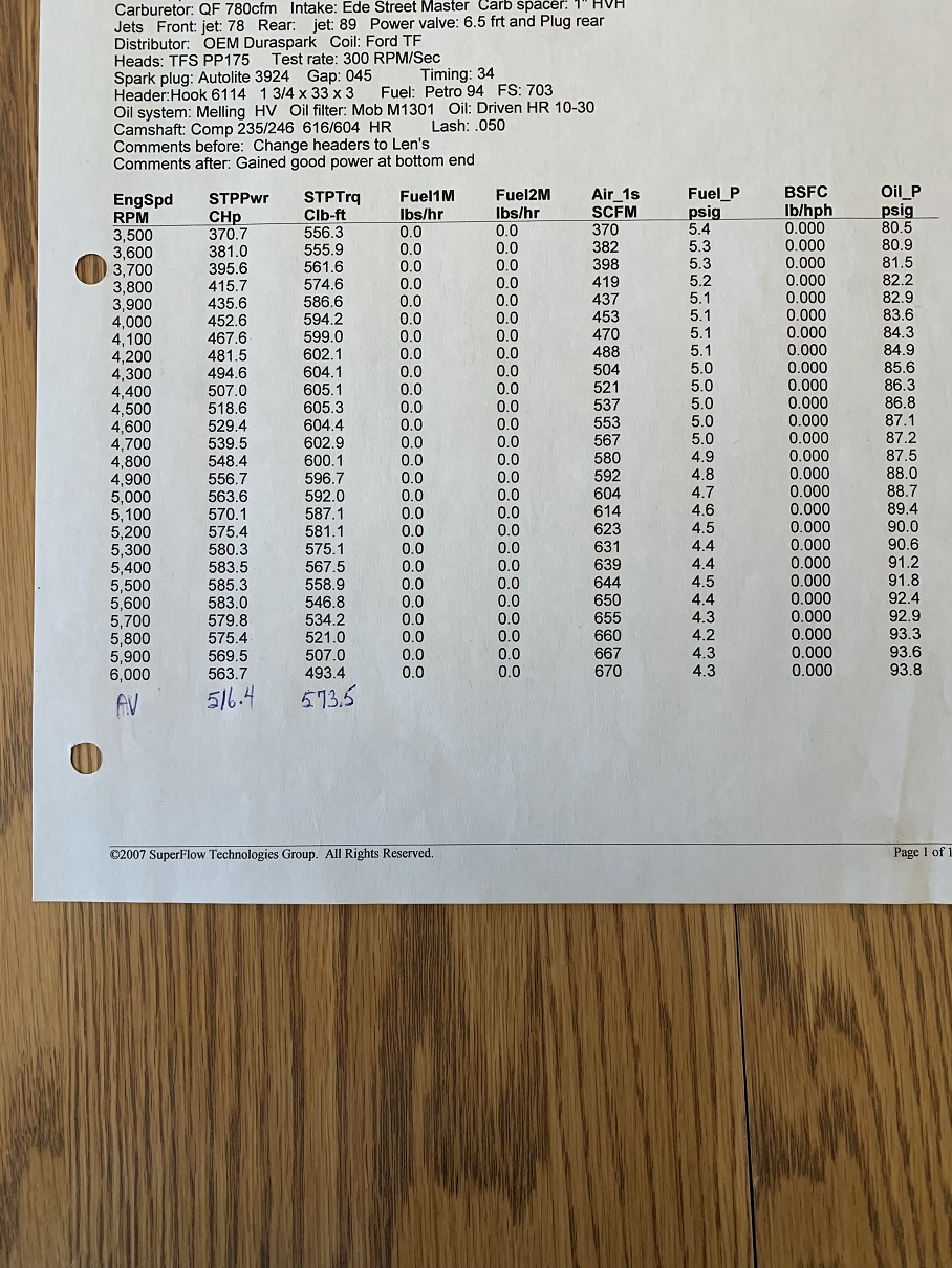

2" Dyno Headers
Hooker 6114
I would’ve thought that the dyno headers would do better than the hookers just wondering if maybe the streetmaster intake is holding it back a little
Re: 464 fe
« Reply #11 on: December 04, 2025, 09:01:06 PM »
Based on my intake testing the Streetmaster intake does begin to be a bottleneck around 550 HP.  But I've tested a couple of similar engines, both with out of the box Trick Flow heads and better intakes, and they didn't do any better, both around 595 HP.  To me the combination looks pretty well matched, and probably more than just headers would be required to take it up much higher.
