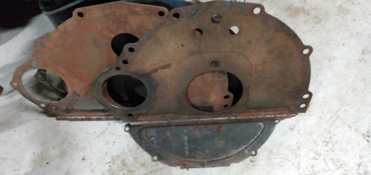

It looks like this. Two pieces.

Mine is same as the top one in tunnelwedges photo with oil plug holes and pressing around crank.
