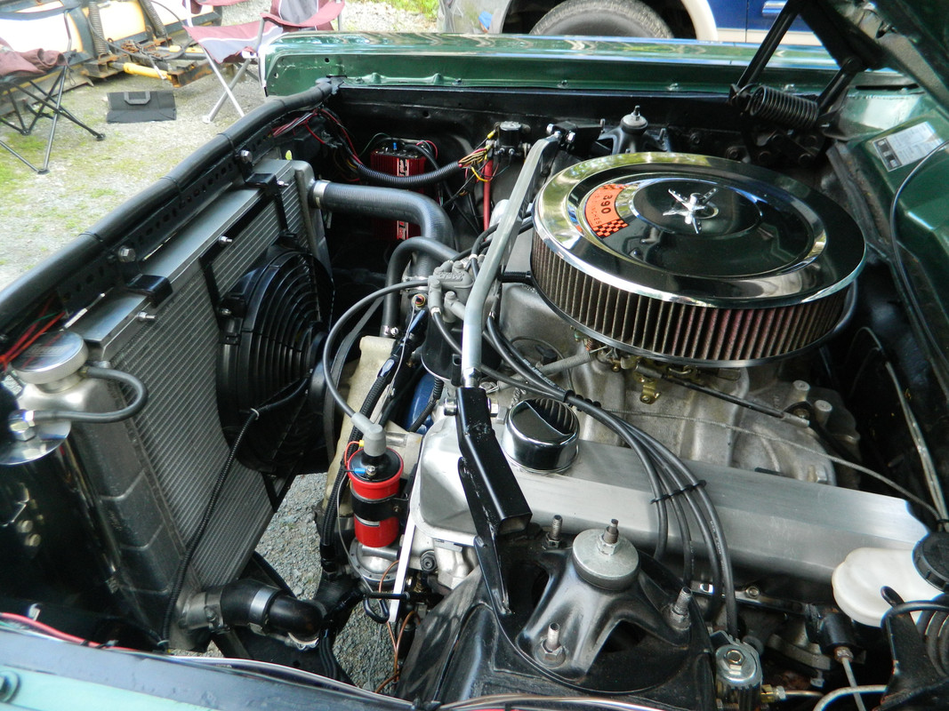

When I got Mine I didn't get the cheap $80 set. The ones I got were e bay specials and listed as 'tall' .they were like $140 about 5 or 6 years ago. I have had them on and off many times with no issues and they fit over my monstrosity of a rocker arm assembly just fine. Maybe I got lucky for once.
Re: Fabricated Aluminum Valve Covers
« Reply #7 on: January 11, 2024, 02:36:34 PM »
Nice lookin' engine.
