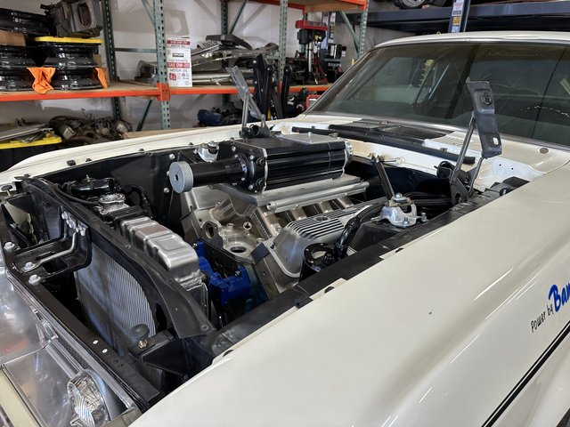

I just did this on the Shelby stocker build. I’m running the fans with dual relays and just added a plug in connector on the end of the wires to each (like Jays). The relays pick up the 12v power from a distribution fuse block with 30 amp fuses and the trigger wire runs up under the dash to the “fan” switch.
