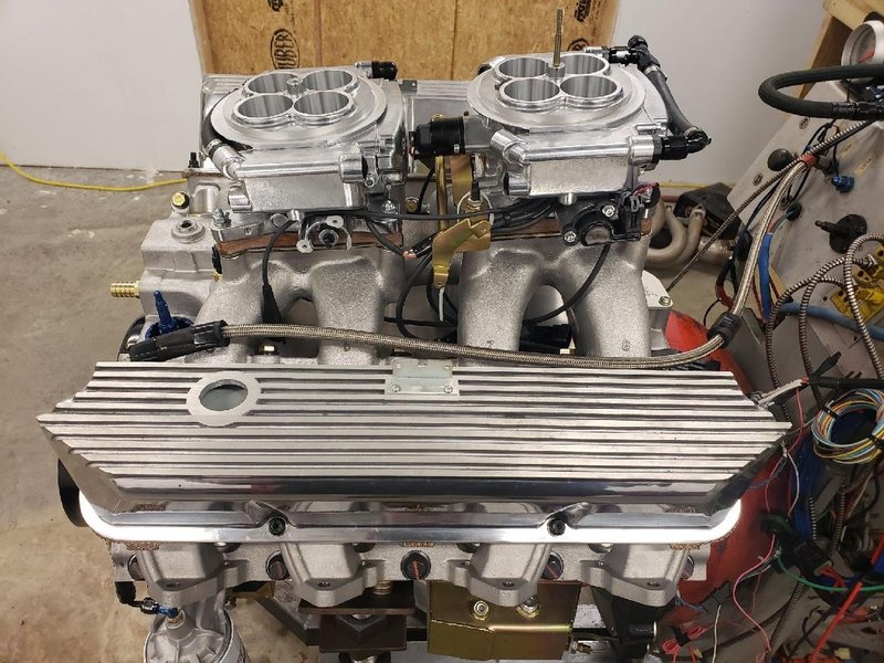

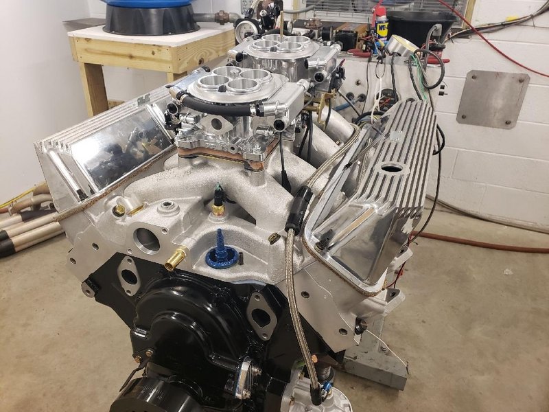

Ok, please forgive my ignorance here, but as you can see from the pictures the carbs do not fit when mounted sideways (which they have to be due to space). I looked around for some sort of adapter plate or something, and was unable to find anything. I waited 6mo for this to finally come in and now I'm at a complete loss and hope I didn't waste almost $3k. If anyone has any advice at all I'd greatly appreciate it.

       Apparently the issue is solely the existing bolt spacing when the carb/T.B. are turned 90 degrees/sideways (though there may prove to be linkage issues impacting the plenum crossover/balance passage also?  :-\)?  If so, then yes the 90 degree adapters are an option (check 4V bore positioning & sizing  ;)), but mostly back in the day of doing this we would choose to add material thru heli-arc welding in order to present bosses for the drilling and tapping of the appropriately positioned threaded holes.   :)

Well, the Offy solution didn't work as it seems they're simply an adapter to shift the carb back about 1/2in. I also purchased an adapter plate from Alkydigger (https://www.alkydigger.net/product/TBS4300.html) and wasted almost $300 there lol, so it looks like I'm going to have to learn how to make my own adapters. I'll update this thread as I make progress for anyone interested.

     I believe the Offenhauser #5880 provides the pair of spacers which offset each carburetor 1/2"; whereas the #5832 provides the pair of spacers intended to rotate the carburetors 90 degrees.  Unfortunately, the later is intended to be mounted to manifolds which present the 5-5/8" x 4-1/4" bolt Carter AFB & Quadrajet pattern, adapting the 5-5/8" x 5-1/4" Holley pattern for the carburetor mounting.   ;)
     Hence, why one may find that the best way is to do a little custom welding & machine work to present that which is needed.   :)
     Oh,............I don't know what size of a welder you may have acquired but when welding aluminum, figure you'll need twice the amps as that of steel, and I would guess that for this job anything less than say 200amp. capacity just isn't going to be enough for a good result.   :-\
