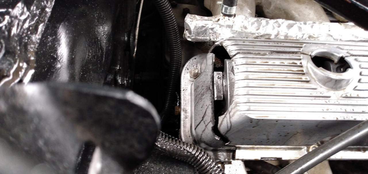

I was testing my new fans and Air Fuel Gauge and the engine started making some noise (unusual noise) and then started smoking a lot.
I was very close to the garage so I got it home.
It looks like I have to take cover off the engine and see what happened.
Something with the rockers most likely.

Did it kick the pushrod out?

So I broke a Sig rocker shaft. ::)
To be fair I have used these rockers for close to 20 years on a 428 then on this 427.
Both solid cams. I paid $600 for them new from Erson. They were expensive then.

I've done that on dyno.
Many years ago, when testing on a very, very early set of BT heads - before the T&D rockers were available.
Pretty serious solid roller.
Broke shafts on both sides at around 6500 RPM or so...
Made a pretty good mess...

That steady speed A/F is fine Howie. If you are under light load cruising it could be a little leaner too.  You’ll get to tune more after that mess gets cleaned up. Some of those upstream adjusters look mangled. Is that just the camera?
You have some spare Erson parts?
I have not done a real close inspection yet. I will retire the rockers now. I have no parts.
I looked at some rocker options, I don't think $600 will do it this time. ;D

Howie, what’s needed there? Obviously a rocker arm and a shaft. Is the stand okay?

I have some arms. The needle bearing assemblies are frozen from being in a humid environment. I have them soaking, could be freed up possibly
