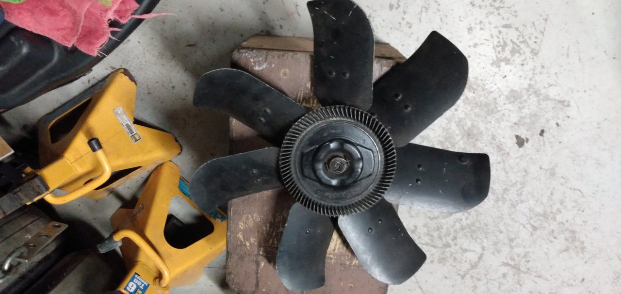

I had a 16" electric fan. I have taken that off now. I bought two cheap amazon 12" Spal look a like fans. 1750 cfm each.
I also have a 428 clutch fan 19 1/2".
I'm going to try the 12" electrics first.
$59 for two fans, free shipping. Worth it? We will see. They come on Tuesday.
Re: Radiators
« Reply #3 on: October 07, 2023, 07:27:17 AM »
Clutch fan, hands down.
I've added: keep in mind Ford's really big.heavy cars (Lincolns, Galaxies, Thunderbirds) and fast one like Mustangs, Cougars, etc. all had factory clutch fans. All could idle in heavy traffic for hours if need be and never overheat.
