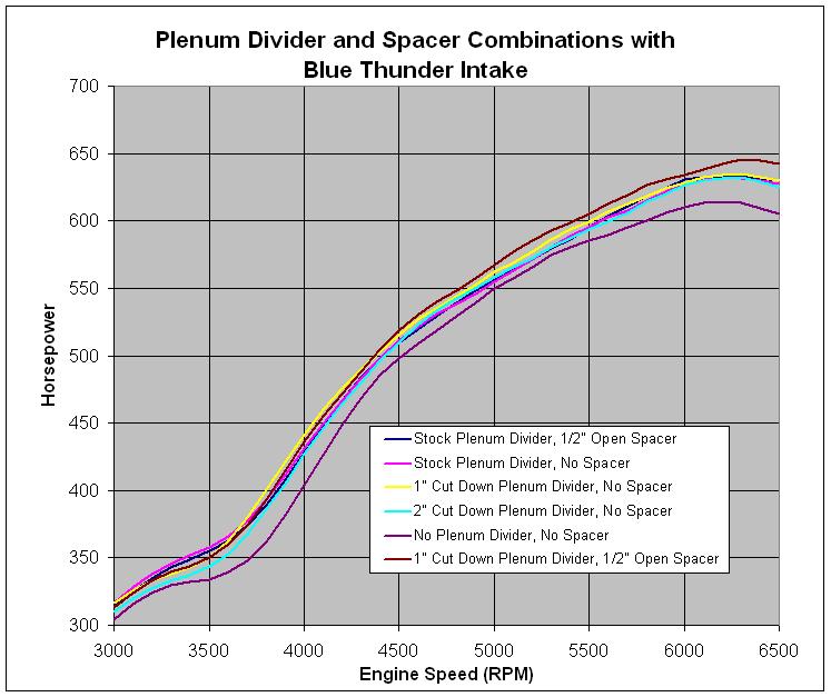

Greg, I did some work on my BT intake back in 2005, when I was building my 492" FE.  At the dyno (not my dyno at the time) I wanted to be able to test several different plenum modifications, so I machined the divider completely out of my intake, then put a slot down the middle of the plenum where the divider used to be, and made some removable walls with different amounts of cutouts so that I could test different variations.  Here's a photo of the plenum of my BT intake with the three different plenum dividers that I used:
The divider with the smallest notch is close to the same as the stock notch in the BT intake, so I considered that to be the same as the stock plenum divider.  The other two removable plates show a 1" cut down across the entire plenum, and a 2" cut down.
I tested this setup with and without a 1/2" open spacer, and got the data shown in the graph below:
One thing for sure is that with no plenum divider, and no spacer, I lost power all across the RPM range, so I would not recommend completely removing the plenum divider in your intake.  I ended up going with the 1" cut down plenum divider, and a 1/2" open spacer.  If you will be running without a spacer, I think just cutting the plenum divider down 1" is your best bet.  FYI this engine was built with ported Edelbrock heads that flowed around 330 cfm on the intake, and a Comp 308R roller cam.  When I swapped to the Victor intake, I picked up 30 HP over the Blue Thunder, so that is what I ended up using in the car.
Hope that helps - Jay

This kind of stuff is always interesting.  The funny thing about spacers and plenum dividers is that the results you have with them depend to a large extent on the engine underneath.  You can't, for example, make a blanket statement that a 1/2" open spacer will always give more power;  in some cases it will and in others it won't.  Greg's engine is going to be really close to the one I did my tests on, so I think my results would translate reasonably well to his engine.  On the other hand, on a 390 my results probably don't mean a thing...

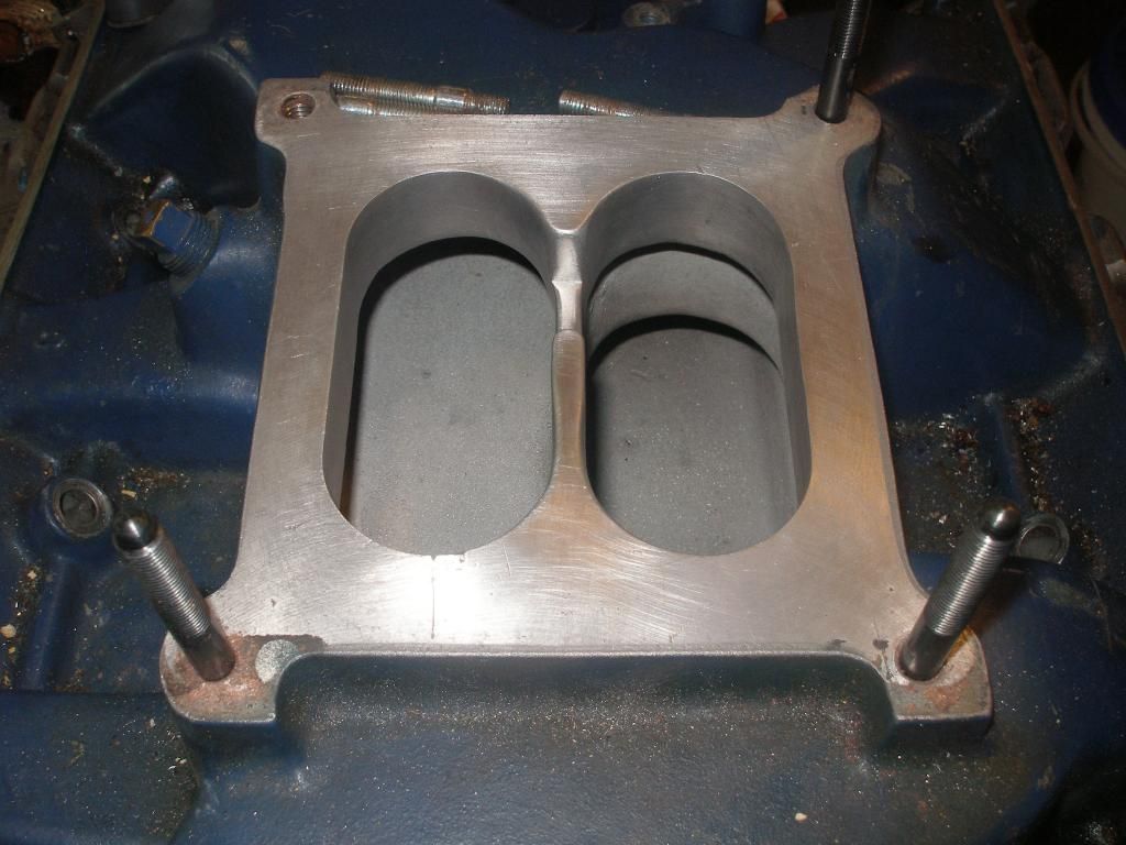

« Reply #6 on: June 24, 2013, 05:28:11 PM »
Thanks for all the input folks.  I ended up going back and taking off some more and finished having intended to take off 0.40", which would leave me with a front height of 4.475".  My final measured front height was 4.471".  That is real good since I was aiming at 4.475".  That leaves me at 0.066" above the stock CJ carb front height of 4.405" (with CJ spacer).  I think I can easily live with this under any ram air hood.  This is what I ended up with after taking out the swirls and chatter marks with a piece of 150 grit mounted on a block of marble.
(I can't figure out how to embed images, so they are just attachments)
This looks to me to be very similar to Jay's "stock plenum divider, no spacer" combination which performed pretty well in his dyno test.
