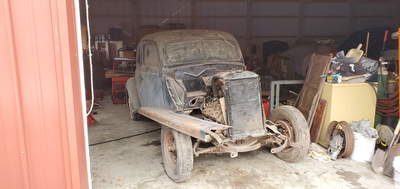

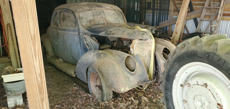

The last year and a half has been a struggle to say the least. After retiring in Nov. of 2021, I busted up my ankle bad while cutting wood, had a heart attack a month later (Christmas eve of all times), then lost my Dad 3 months later. It's taken a while to recover from the heart attack, but I think I'm about back to 100% now.
My Dad introduced me to flatheads from the time I could walk. I used to help him rebuild them, doing anything that a young kid could do. I'm now going back to those roots. I've been collecting parts for this '37 Coupe for years. It's a super solid car, but has been in storage for the last 50 years. I helped my Dad rebuild the engine, but it only has a few hours run time on it....50 years ago. I decided it was time to finally dig it out and restore it.
The plans are for a full on restoration, to a level that I did my Mach 1 to. I have some really nice hard to find pieces for it and am currently tracking down the last couple of parts that I'll need. It'll be 95% original, with the only changes being lowering the front about 3" and rebuilding the original 85hp V8 with some speed goodies. I have an Edmunds dual carb intake, some NOS Stromberg carbs, a pair of Edelbrock heads and I'm considering putting a Mercury stroker crank in it, which I have. I still haven't made a final decision on that one though, but regardless, it'll be a vintage type build with the original drivetrain.
It's already in my garage and I've already finished taking the nose off and stripped the interior out and will be pulling the body off the chassis this spring. Everything will be gone through. There is remarkably little rust in the car, with the only repairs needed being at the lower fronts of the rear fenders and a small spot on the floorpan. Everything else is solid and just needs stripped and hand finished. I'm excited to get this thing on the road and plan on driving it every day so long as it isn't raining. I figure it'll be a 2 year job, provided nothing holds me up.
