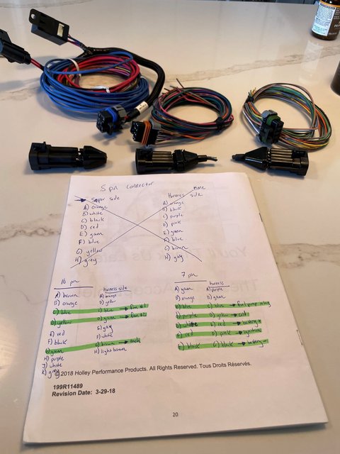

The very first thing I did yesterday is do some investigation on the unit wiring, and then snipped their UGLY connectors off. The unit has 23 inputs/outputs and I need 8 of them. I going to combine those into one clean connector and get rid of everything that is unnecessary. I'm drawing up a wiring diagram for myself today and going to start getting some of the wires pulled this week. The battery is in the trunk so that adds a bit of a hurdle for getting the unit powered.

Ross, I spent a solid hour looking back and forth at the wiring yesterday. Their pinout on each harness setup was correct. What I thought was fairly dumb is the colors leaving the sniper don't match the colors at the harness. So I had to make myself a conversion chart of what wire I need from the sniper and what color it will change to at the new plug I'm making.

I was able to consolidate all of the input/output wires into a 6-plug connector and then I have another 2 plug connector for the power/ground connections. Now that the sorting and planning is all done, wires will be run quickly. I'm thinking about getting our neighbor to machine me a mount for the MSD capacitor and the coil driver module that will mount to the carb stud and hide at the back of the unit.

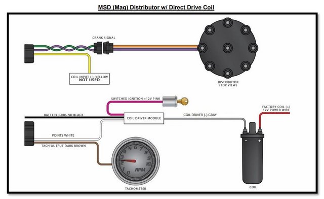

This is the wiring diagram for this dual sync distributor situation. Note that there is a "coil driver module" that's not really talked about anywhere that I had to buy.

What does the coil driver do in the installation?  I've installed Sniper/TermX Stealth on two FEs with locked out Duraspark/MSD6A ignition setups and didn't need any additional boxes or other stuff.  Also installed a Holley HP on a sequential setup using a Sniper CD box, and a Ed PF4 on my Z2363 small block with a 6A box.  I guess all my stuff has a MSD 6A or Sniper CD box installed.

This is the route you take if you want to avoid a CD box. I thought about running the hyperspark CD box that pairs up with all this, but I don't have anywhere I care to mount it. From my understanding of what the "coil driver module" is, seems to me that its a transistor in a box. The Sniper unit signals it, and it opens/closes the coil circuit. This way you don't have all that electrical noise from the coil messing with the Sniper.
