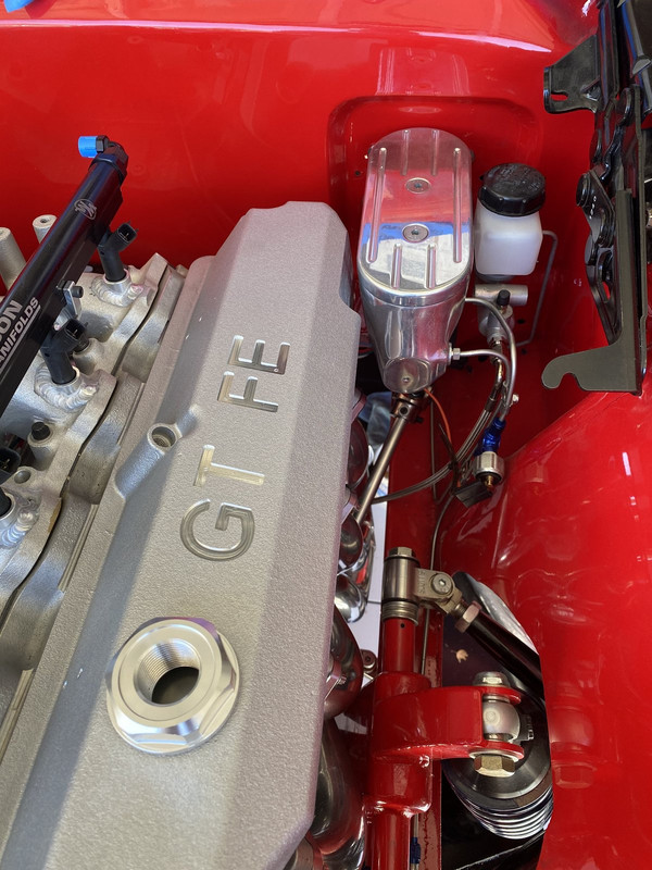

Marc thats cheating

« Reply #7 on: March 28, 2022, 09:51:11 PM »
Marc, that thing is clean.
Nice!

Yeah another guy posted saying that part number I believe fit on his with the same steering box I am using. I didnt want the small tubes however . These are 2" with merge collectors .
And yes . Marc is a cheater....

Re: Get a big block Mustang they said , it will be fun they said.......
« Reply #13 on: March 29, 2022, 08:59:02 AM »
Yes, yes I am :)
TJ
  • Posts: 216
« Reply #14 on: March 29, 2022, 09:38:27 AM »
Lot of cheating in turbohunter’s pic…port fuel injection and I’m guessing a hydraulic clutch…I’m jealous.
