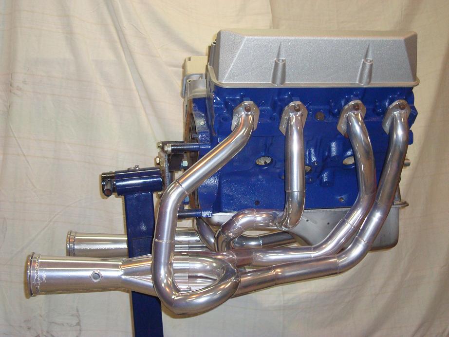

So there is the rub . To get a 2 or 2 1/8 into collector on either side you then have to do some pretty stupid things with the tubes to keep them at about 40"  . In the mustang chassis this means tight bends around in circles
For instance , cyl 1 and 2 is right about 40" total length . Number three you can get the 40 without too much gymnastics , but some  , well now that youve done that number 4 is simply a nightmare. Doing number 4 without what youve done with number three wouldnt be bad but you had to do it so now here we are... If we cross that 4th tube over then it removes it from the equation and keeps its length and you do your 3rd tube and go have a drink or a smoke or something...
If you want to pack them all into their individual collectors you end up with this https://i.postimg.cc/C5hnJBGR/REF-FE-Headers-Mustang-Cougar-390-with-automatic-006-rs.jpg . Mind you , you still need to steer the car and that mess is all kinds of hindering that endeavor !!!! I would love to see those things on that cougar in detail to see just how its woven around the steering components.
