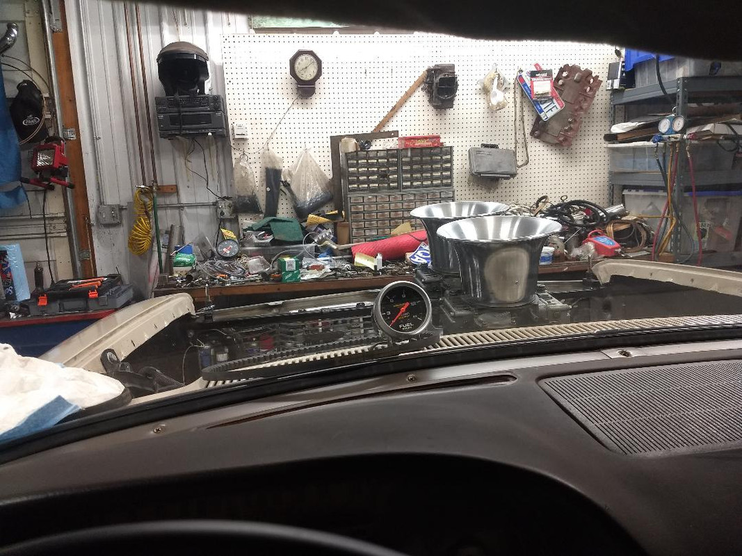

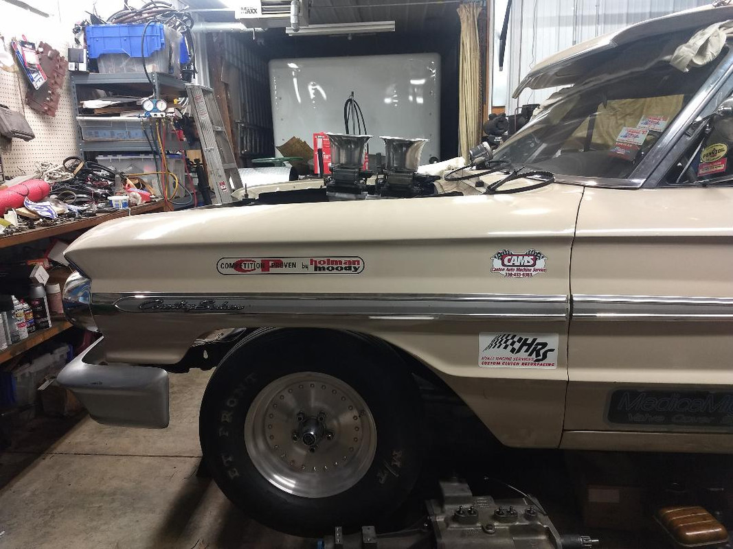

That's a beautiful piece Larry... there is NO WAY the hood will close on it as it sits. I assume the velocity stacks are for dyno time only? Good luck, Val.
Test fit before I pulled the engine...

I kinda wondered about air flow at 130 mph and if it will actually pull fuel away and splash it on the windshield?  Time will tell.
