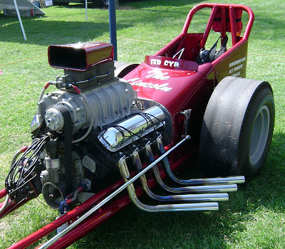

You may be over thinking this, a little.
I have some personal experience with old blower manifolds and street driving. My best friend had this car and he and I did all the work on it, frame body, drive train and engine. It was a 326 Olds, with Herbert roller cam and a 471 with dual AFB's. There weren't any dividers for the ports, just a open hole, for each pair of ports but, because the heads aren't as far a part as the MEL, the plenum was a little smaller.
It weighed about 2200 and with the smaller engine, it no flat spots and a smooth transition from idle to any speed, part throttle or WOT. Instant torque! It actually got good gas mileage, too. I think that was because the rotors helped with atomization of the fuel.
Now, at part throttle, on a dyno, you might be able to see a difference, with a well designed manifold but, on the street, I believe you would be hard pressed to tell in by the seat of your pants. Once the plenum becomes pressurized, at any level (and that does not take long), the A/F is at the valve, ready to serve the cylinder. Remember a pressurized vessel, has equal pressure in all directions.
I would agree that the water ports are small and look like 3/8 pipe, to me but, it looks like there is enough room on the boss to take them to 1/2 pipe. I think 1/2 would work for anything but sustain HARD pulls. Back in the 60's and early 70's, there were street driven cars with 671, that ran with a pair of Jabsco 12V water pumps (like for RV water systems). They seemed to run ok at street level driving, in SoCal but, I wasn't associated with them so, I can't confirm that they were trouble free. Georges coupe had the std Olds pump.
The biggest thing, as I see it, is making a 90° or a offset drive, for the dist.
« Last Edit: September 30, 2021, 02:21:18 AM by frnkeore »

Frank, that had to be the bitchinist car in the valley!
Sorry, I couldn't resist the obvious Milner comparison.  ;)
Cool car.
  • Posts: 1345
Re: Intake Manifold Design - Forced Induction (MEL)
« Reply #12 on: September 30, 2021, 11:44:53 AM »
It was and we were almost, always stopped by the cops when we took it out. The HR picture, was in the Nov '64 issue and a preview for the Orange County Car and Boat Show, held that Nov.
Although I don't have any pictures of it with my 427, it is the the car that I put my LR in, before he sold it and I went formula car racing. He put the Olds in a flat bottom boat.
