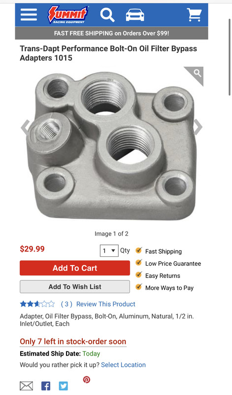

The Precision Oil Pumps one is nice, and a nice feature of that one is they staggered the height of the ports, it can make it easier so the fittings don’t interfere with each other.
Trans-Dapt still makes one too. It’s cast aluminum, not billet. I used one of these years ago on my 427, worked fine. But with the ports on the same level I remember it was a bit tricky with AN fittings getting the hex flats of the fittings to clear each other. It’s do-able, just something to be aware of.
Screenshot from Summit:
Re: Remote filter
« Reply #4 on: March 04, 2021, 06:48:17 PM »
Been using a Transdapt version on my 69 f100 for near 3 decades.  Yes, bit tight for using AN fittings but does work.  Remember to use BIG hoses.  #8 or #10.
