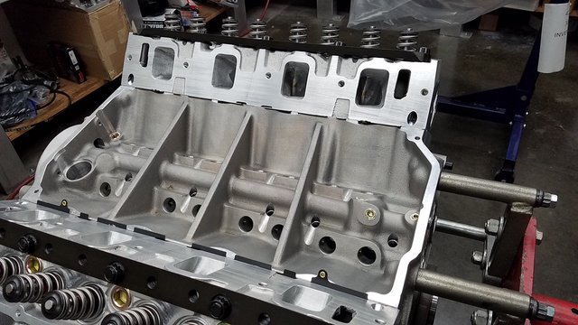

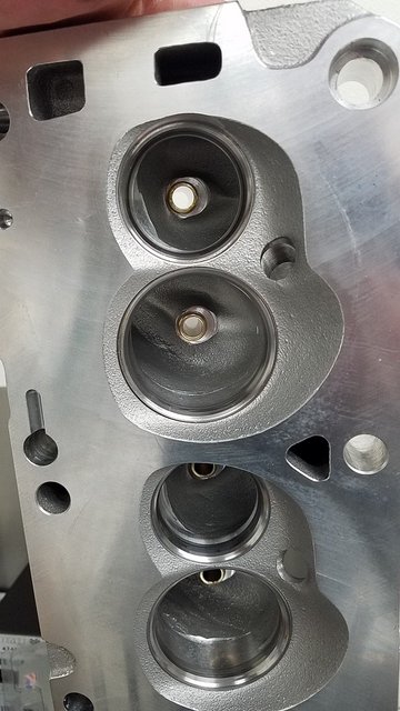

« Reply #10 on: February 19, 2021, 10:18:28 AM »
Some pictures of the newer design heads. I think they have been around for about a year now. I have no idea how they flow or perform, just know that they exist.

« Reply #11 on: February 19, 2021, 11:11:14 AM »
Maybe just the angle, but those look like fairly large ports.

Re: Shelby FE Aluminum Heads
« Reply #12 on: February 19, 2021, 12:05:33 PM »
The new combustion chamber does look like a substantial improvement.
The Shelby site says 55cc as cast combustion chamber - I like that alot.
Intake port volume 195 cc and 305 cfm - does not mention at what lift.
« Reply #13 on: February 19, 2021, 01:32:52 PM »
Combustion chamber does look nice.  195cc with 305 cfm is pretty stinky compared to a lot of today's offerings.
