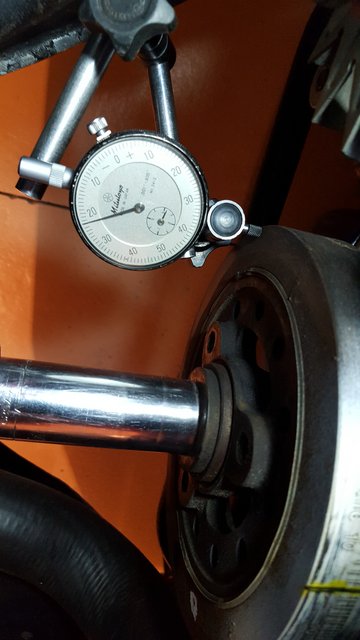

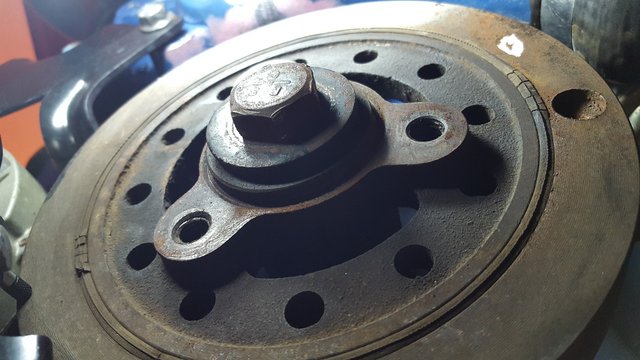

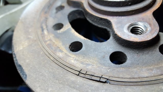

Today I removed the three groove crank pulley to get a better look at the original, 52 year old balancer.
Using a dial indicator, I found the outer ring has .023" run-out, measured on front surface. The rubber strip between the two inner and outer rings is old and dry. The .023" variance corresponds to the two pooched out, cracked areas that are 180 degrees apart, see pictures below. This quite likely is the source of the 1000/1500/2000 vibration.
What to you guys think?
How long should a balancer last?  ::)   I would have looked at this sooner, but using a piston stop I determined that the outer ring had not slipped and the timing pointer indexed on TDC....on that observation, I thought the balancer was okay. I have never heard of the outer ring tipping horizonally
What brand do I look for in a quality OEM replacement? This is a street motor, but I still want a good one with precision timing marks.

Clark that balancer is junk, it is in the very least moving but it almost looks like it’s wet all the way around. Even if it’s not the source of your shake, which probably is, just swap it out before it comes off and breaks something
New replacements are cheap, Pioneer, and others. There is a decent company in Kansas I’ll see if I can find their card and post it here tomorrow

Beautiful car  and yeah , ditch that balancer either way... I think you have narrowed this down pretty far with that last long post. Its going to be that balancer or something internal. Thats my two cents...Things like bad carbs or ignition issues are always exacerbated by load and usually get worse with time . Since your issue seems to have hung on and been consistent it seems like a hard balance issue. The nicer the car the more obvious small issues are and it looks like you have a really nice car there.
