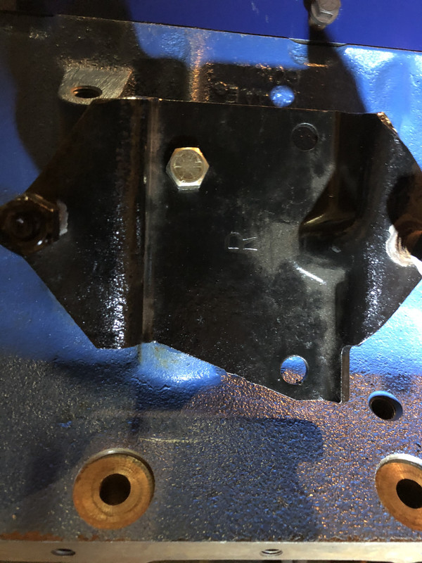

Here’s a picture of the ‘67-‘70 Mustang/Cougar FE mount plate and a ‘64 427 with the early 2 motor mount block holes. The mount plate will only have one hole that corresponds to upper early block pattern. The forward wider spaced holes will be unused. As was suggested, there is enough material on the block plate that you can drill the other lower hole that’s needed, although it is close to the edge. My suggestion would maybe be to use a later block with the 4 holes if available to use as a template, or to make a cardboard template, so you can bolt the mount plate to the block and know it’s lined up properly before drilling the needed hole, so the mount plate doesn’t inadvertently wind up “tipped”. If because of manufacturing tolerances you find the needed hole is on the edge of the plate you could weld on a slight bit of steel plate extension in that spot.

The 2 rear most bolt holes in the later blocks are in the exact same place as the 2 bolt holes in the early blocks. That way the later production blocks were able to be used as replacements for the early blocks.
See my picture above, that’s an actual FE Mustang/Cougar block plate on an early block, just need to drill one hole. On other FE powered vehicles there are various other methods needed to adapt.

Wow Kevin, You've removed any guess work for me. lol Thank You very much for the pictures. Made it easy to understand.
