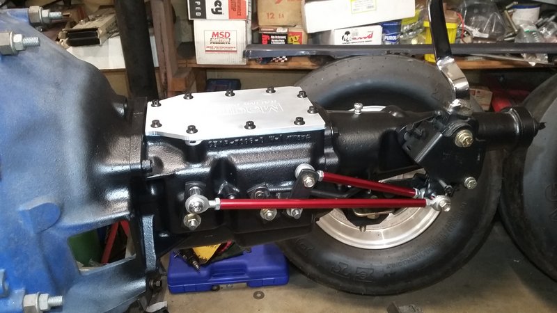

Re: shifters
« Reply #13 on: December 16, 2020, 11:22:55 PM »
what kind of 4 speed shifters does hurst offer besides the competition plus? in the end i would like a shifter that is good for street racing-drag.i had a comp plus shifter in it back in the eighties,i never could bang shift it.
They have a "Super Shifter". That has a much shorter straight stick that bolts on. Reverse lockout is push down and go over/up into rev. Also requires a bit of butchery to the tunnel hump to fit, because the shifter sits over with long standoffs for a straighter shot with the linkage. Will not fit with a console. I have the Competition Plus in mine and retain the factory console. I can shift "okay" with it, I still need practice. But, the 2' long stick doesn't help much. The only real problem I have with it, is I can't seem to downshift quickly from 3rd to 2nd. I just can't bring myself to get rid of the console for a Super Shifter or even a V gate. I think a V gate takes some of the fun out of it. There's something about the H pattern for me. The Competiton Plus I have, has the stick welded on. Mine is an original from the 70's. The current units are still made the same way. See here:
https://www.holley.com/products/drivetrain/shifters_components_and_accessories/manual_shifters/parts/3913180
I made my own linkage for 1-4 with heims. I left reverse alone.
