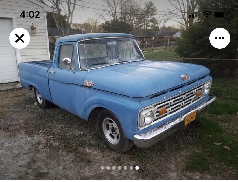

Been looking for something to house a 408W and Performance Automatic C4 that I've had a LONG time.  Was targeting an F100 because I don't mind "patina" trucks and wanted something that wouldn't break the bank and could be built fairly quickly, after a year or so casual search this poppped up 3mi from my house.  Owner is pulling the engine/trans, I'll pick it up in ~2wks.  Front cab mounts and door pillars have already been fixed, I'll be fixing some relatively minor rust in the rear quarters and front of the bed, typical for these trucks.  Compared to others I've looked at in this area, in this price range, it's a solid truck.  Crown Vic frontend already tacked in.  I'm planning to put a 4 link in it and 4whl disks to make a nice little shop truck.
408W was originally built for a street/strip fox body Capri so it's a bit snottier than what I'd build for the truck, but it's what I have on hand.  242/250* hydro roller, 4500rpm stall...so I'll put 4.10 in the truck and it will be a short run shop truck kind of deal.  Engine made 570hp/535ftlbs, think the truck will come in around 3700lbs so shouldn't be too heavy for the combo.
No real plans to paint it, repainted with some type of cheapie "thick" paint so it's not a patina truck, just ugly.  Want to run some American Gasser or Rocket Injector wheels so keep it old school appearing.  My Merc was not a full frame off, I'm excited to do a frame off on the truck, much easier as it can be taken apart in pieces.  I've never done a full wiring harness so this will get a Painless/Ron Francis/AAW type deal, which will make it easy to run an in tank electric pump and electric fans, and radio...I'm not a big gadget guy so that's about it.

Very cool.
That paint looks like it’ll rub out just fine.
Having the T&C front end already tacked in is great. Four link shouldn’t be to much of an issue, then you’ll have a solid truck.
How ‘bout an old style speed shop logo on the door? Chilly’s speed shop, or some such gobbledegook.
