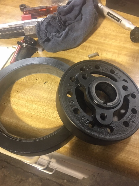

4 - If anyone is using a rebuilt balancer from Damper Docs, go grab the ring NOW and see if it comes off or moves.  Don't even read the rest, run out there and check before you drive your car....I'll post pictures, but from pull #1, we had timing marks that didn't make sense.  Turns out that first fire, the ring slipped, and then I reached down and pulled it right off.  TDC had checked good at assembly, but all three pieces, ring, hub and elastomer, were not adhered.  Luckily we caught it and swapped the balancer before we started comparing carbs.  Thanks to Brent for pushing me to tweak the total more to try to get some power, if he didn't, we wouldn't have lost the timing marks, and likely wouldn't have made another pull with a carb swap...with date coded water pump, timing cover, some expensive pieces and 6400 RPM, it could have been ugly.
Talk about an odd discovery, Brent running the dyno up, me on the light, and I didn't have any timing marks.  The joke on this dyno is that timing lights are always failing or damaged, so I checked connections to be sure and then had him shut it down.  When all looked good, we looked at the elastomer and it was in 1 piece but looked strange, I grabbed it and the ring popped right off.  Swapped the balancer, and what we thought was 38 degrees total, was really 45 degrees, which tells us it was bad from the first fire
Including this build, I have only used them twice, but I already went back to the the prior customer to be sure he checked his. I won't ever use another, it came apart easier than you could imagine.  Like it was held together with a lubricated strap....but was dry

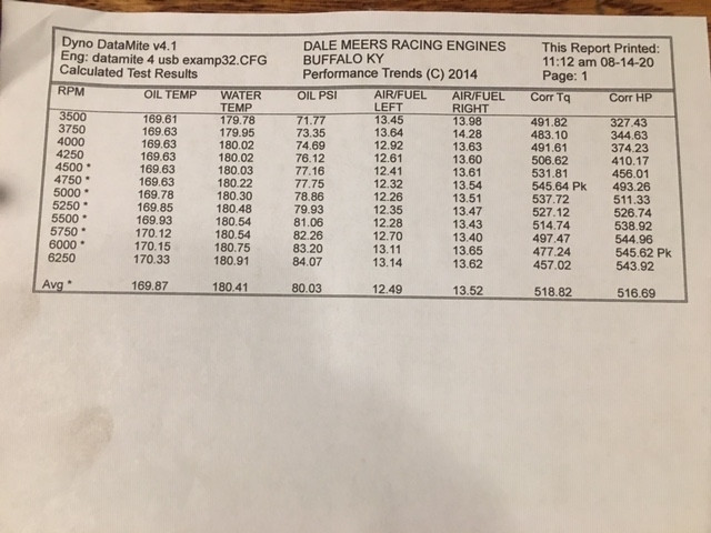

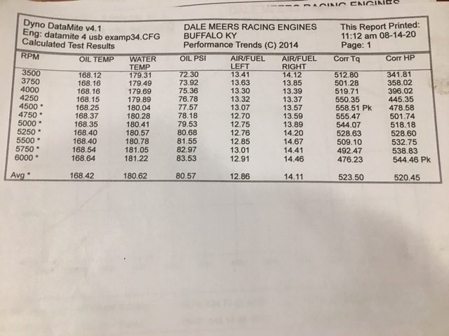

OK, so here is the more exact data.  In both cases, realize the chart somehow is slightly off the graph, I tend to use the data off the chart because it has more info.  Not sure why, but the graph extrapolates slightly differently if you are comparing.
But first....a good look at the Damper Docs damper...just seemed to be held together with something that didn't stick to anything.  Buyer Beware!  They do have a good rep, we'll see what they say
FYI - I always install with an installation tool, and it came to me in a box from the company.  Given that it started slipping on initial fire, my guess is it was a bad bond from the start.    Talk about lucky, if it would have let go, it would have been a very different day!

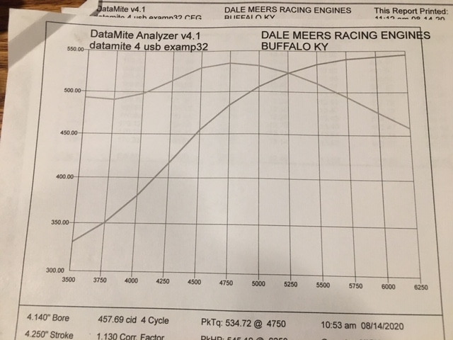

Here is the 457, although it would look like it was still climbing on the graph, the numbers were leveling off after 6000.  Watching the dyno I saw 6400 on the tach, without so much as a burble.  It was very clean, not sure why the chart stopped where it did, must where it stopped collecting based on load.  This was built to be a 6000 rpm peak, so it's where we want it, so no surprise. It liked 38 degrees of timing, no surprise there either
Ironically, the two 465s had the slightly higher HP peak, and the two 750s had the higher torque peak, backwards to what you might think.  545/545 vs 544/558,  HP is within spitting distance and I would call them equal, but it does show Drew's carbs were working nice, and should tell people yet again that "small carbs for more torque" is a fallacy.
I make no excuses for this engine, it is a fun and bad mofo, but there were some differences in the dyno runs when you look at both.  First, note the engine temps, I think there was 10 more HP if we finished up with a cool down, however, losing the balancer, checking everything out, and doing some carb swaps ran me out of time and I wanted to give both motors time on the pump.  Second, we saw the most torrential rain storm I have driven in for a long time and the weather changed significantly at lunch time for the second engine.  Although the dyno will adjust, I do think the TW would have been called the winner for peak HP if things were a bit more stable, but likely not by a wide margin.  In a 4 speed 4.11 68.5 Mustang, this will be a stout runner
450s
750s

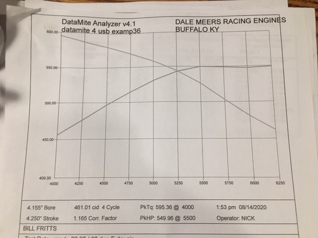

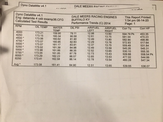

Here is the 461, it was a pretty easy dyno run after switching balancers back.  We ended up at 32 degrees of timing.  A little less than normal, but in the ball park, likely due to the shallow dish and tight quench. This was a gentle and happy build.  558/594 peaking at 5750 RPM.  It also had no problem at all hanging in as high as we wanted to pull.  This one is going in a 63 or 64 Gal, with a 4 speed AT Chevy box conversion.  The curve should very nice for the use.  Less drag car than cruiser, but should still be able to scare wives and small children at ease :)
In the end, two very happy motors, one more snarly and vicious attitude than the other, but both will be very strong runners.

As far as the balancers....man oh man, can you imagine if it let go?  I will look closely, never know if the ring has a little crack, that would certainly expand with a little heat and cause the bond failure.
Ross, those are great motors and will obviously work well for your customers.  Having said that, the curves shown on the dyno data have been smoothed, and are therefore a little misleading.  Look at the second set of results.  The HP curve is nearly flat from 5500 to 6250, at 550 HP.  Looks great!  Now, look at the corresponding numbers:
5500:  555 HP
5750:  558 HP
6000:  545 HP
6250:  547 HP
The data shows that something is happening with that engine between 5750 and 6000 RPM, because power is dropping off.  And it is dropping off in a non-linear fashion.  I will almost guarantee you that it is valvetrain control, probably the hydraulic lifters giving up.  Seen it literally dozens of times before on my dyno, and a couple times I've pulled the hydraulic lifters and replaced them with solids, just to see if it was the lifters.  And it was.  There's a quick blurb in my book about it, along with a graph.
Now let's look at the first set of data.  The graph shows a steadily increasing horsepower level from 5500 to 6250.  Again, it looks great.  Now look at the data:
5500:  539 HP
5750:  545 HP
6000:  545 HP
6250:  544 HP
The HP is rising up to 5750, then it goes flat.  But that is not what the smoothed curve shows.  Again, it looks to me like something is happening with the valvetrain between 5750 and 6000 RPM that is flattening the curve.  Again I would suspect the hydraulic lifters.
The moral of the story is, look at the numbers, not the smoothed curve.  Or else, take the smoothing out of the curve plotting algorithm.  You may notice on the dyno results that I post that the curves are rather jagged; they don't look as nice, but they may tell you more.
