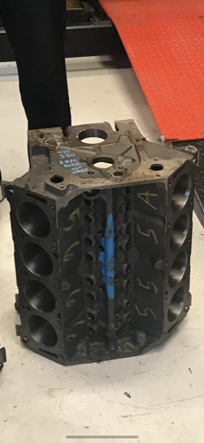

I went back through my photos and found a picture of a NOS 330 block we have. We sonic check the blocks before we put them on the rack, I toss a sonic sheet into the bag with the block but we always write the thinnest reading on the front of the block. It's hard to see in this picture, but when I zoomed in I read .270". That would be the thinnest reading shown on our sonic sheet. As I remember some points on this block were near .400".

wow!!. That is thick!. Is my math right when I calculate that block has a std bore of 3.8750" with a MINIMUM thickness of .270 leaves a possible overbore of .240(.120 per side)would achieve a 4.115 bore with a minimum cylinder wall thickness of .150
Is that right??

I don't know if you'd want to go that thin....I think typical consensus is to keep it above .200" if you can help it. Let me see if I can get at that block and take a picture of the sonic sheet. Then all the engine builders on here can chime in with how far they think they would take it.
