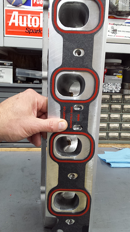

I certainly don't agree with most of these comments.  I will try to explain why.
First, it is important to realize that flow numbers are not everything!  Flow velocity through the port is at least as important, and perhaps more important, because it directly impacts how quickly the cylinder fills after the valve opens, and how long it keeps filling as the valve is closing, while the piston is coming up from bottom dead center on the compression stroke.
On other FE cylinder heads, the only way to get big flow numbers is to increase the size of the port.  This increase in cross sectional area of the port reduces port velocity at a given airflow rate, making for a low velocity, sluggish port with a 425-440 cubic inch engine.  Especially at lower engine speeds, a low velocity port is going to make for lower torque numbers and a less responsive engine.  In that case you need a lot of cubes to increase the airflow and get up to a decent port velocity, so that you get good cylinder filling as the valve is opening and closing, and good low end torque.
My cylinder heads, on the other hand, do not have a significant increase in the port's cross sectional area.  The cross sectional area at the port opening in my heads is about 4% larger than a factory medium riser port, and quite a bit smaller than a factory 428CJ port.  So, for the same given airflow rate, the velocity through the ports in my heads will be about the same as for a good stock or aftermarket head.
The reason my heads flow so much better than other heads is that the port is raised nearly an inch and a half over the stock medium riser port location.  This makes the short turn dramatically better than any head that relies on the stock port configuration.  Also, since the ports in my heads are straight in like a tunnel port or a cammer, rather than hooking towards the center of the engine and aiming the flow at the cylinder wall, flow into the cylinder is much improved.
At the higher airflow rates, velocity through the ports in my heads will be much higher than can be achieved with a stock type or aftermarket head.  Again this is achievable because of the very generous short term radius, and the straight shot into the cylinder.  Without going into all the details, an increase in port velocity without separation of the flow from the port wall is going to result in better cylinder filling and more power.
I think it is probably true that the 4V and 8V intake manifolds would cost some low end torque when compared to something like a dual plane manifold.  However, it's possible that the heads may crutch that to an extent, making the combination of my heads and intake as good or better than a stock type head with a dual plane intake.  I won't know on that until I do some dyno testing on a smaller engine, like a 390 stroker.
For what it's worth, I do plan to make a version of my heads available with a smaller intake valve, and a slightly reduced port size, so that they can be used on a 4.08" bore.  I'll reduce the size of the runners in the intake to match.  I'll build a 390 stroker to test these heads, and probably make it a 600-650 HP engine, so that I can compare it with some other aftermarket heads.  It will be a while before I can get to that, though  ::)
Also for what it's worth, I plan to run the existing heads on all my street cars.  I expect that they will perform better than any aftermarket head that is currently available.
Once again, flow numbers are not everything.  Drawing conclusions based only on flow numbers will only lead you astray in your quest for performance.
This is what a lot of people miss, getting caught up in flow numbers.  Even Kaase basically says flow numbers are a distraction.
Stock 351C 4V head port is huge, about 260~270 cc.  And in stock form, they barely get to 280 CFM.  Kinda sad sounding for a port big enough for a comfy gerbil den. The bottom of the port doesn't do much either.
So we crutch it using port tongues to fill the lower part of the port.  This reduces volume into the 220cc range.  It also raises the floor and give a better shot at the pocket.  With a few days of updating the pocket and blending the tongues into the port, now we're running 340+CFM at only .500 or so. Not bad for old tech.
Or, you can just buy an updated part - shown is an AFD "4V".  Same, about 220cc intake and the flow is never less and mostly way better than the worked, stuffed old iron part.  Velocity is better and the chamber is completely re-designed also.  The 4V closed I run handles 37~38 degrees timing.  The AFD - 26 degrees.  And - no labor.  Just bolt it on.  With the updated port runner and pocket, it works great on even a 351 cid engine and even better when you add CID.
For extra credit - a 351C 2V port - these run in the 180~190cc range.
Wow, looks like the AFD, must be pretty close with a little work.  Well, not so much.  Even when carefully ported, at about .450 or so lift and 28 in/hg depression you will likely hear a loud BANG as the air flow through the port fails to make the short turn.  The floor is very flat and while velocity is good, the air can't handle that sharp curve.  On a set I have, we hit about 250 CFM then ka-pow, lost about 30 CFM and did not recover until nearly .600 with nothing after that - 254 CFM max.  Not much good for velocity right in the middle of typical lift range, would be pretty disruptive IMHO.
Bottom line - learn a lot when head shopping.  Way more to a good head than a set of flow bench numbers.
If that's the case, I stand corrected, assuming intake options support the behavior.  In fact, that's awesome, much like the CHI heads took off on the Clevelands, these would do the same.  No need to explain airflow to most of us, I mistakenly assumed that this was a high port with big honking intake options for big inch RPM engines and volume was very high.  I certainly wasn't basing it on flow numbers because 345 isn't much more than a TFS head if that is the number.  What is your port volume, assuming of course it will change with throat diameter...? Second question would of course be, with that given volume, is the port significantly longer or shorter for comparison?
I will say, in truck packaging, if a long, properly sized intake runner with a reasonably sized plenum could be used with available  hood clearance, it'd likely do very well.  To your point though, the head is only one part of the port and same caution needs to be taken there if unable to run stock design intakes
