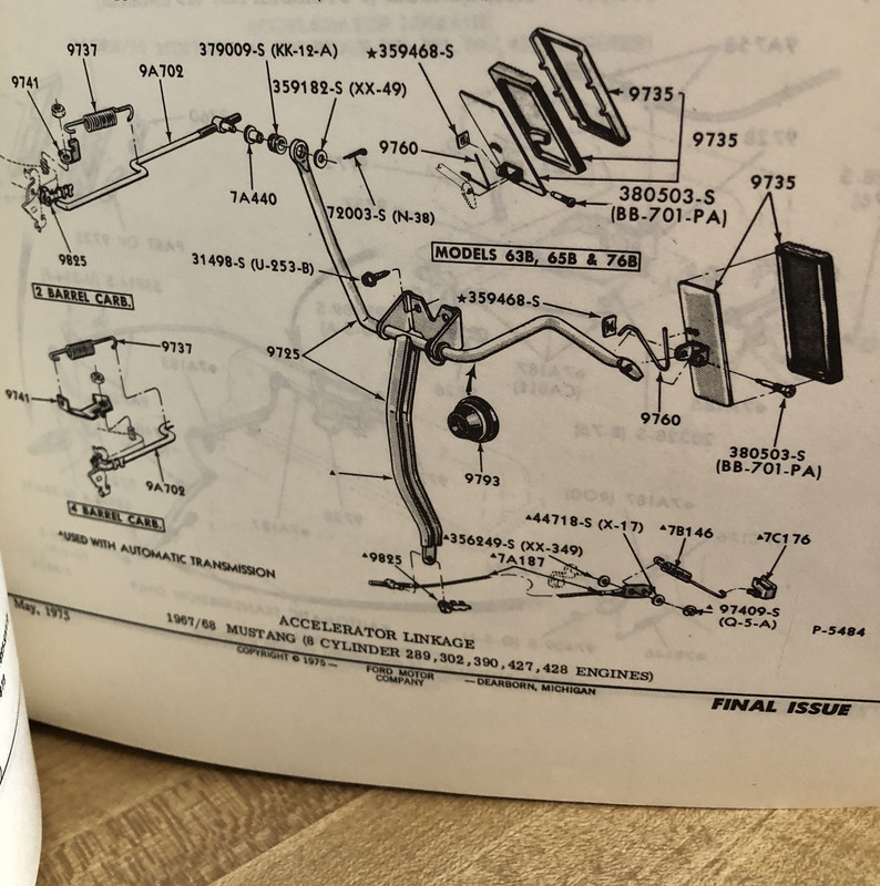

Sorry to hijack a thread but anyone know how they managed a kickdown on that setup? I cannot clearly see it.
  • Posts: 1963
The kickdown on a ‘67-‘68 Mustang/Cougar works off the accelerator pedal rod on the firewall. The automatic transmission cars have an extra arm that extends down on the firewall side, and then a short cable that attaches to the kickdown arm on the transmission. It doesn’t attach to the carbs. Makes it real easy to convert to a Ford multi-carb intake.
Diagram from the Ford Parts Book.

Stole that pic. I get asked all the time.
I like that they listed a 427 under engines for the 1967 / 68 Mustang.  ::)
