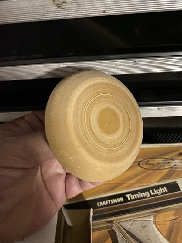

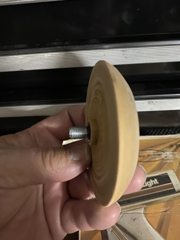

Any chance you could post of photo of what this "eraser" looks  like? My enclosed car trailer had vinyl lettering all over both sides, I spent hours trying to peel off the ols stickers and lettering, but for the most part, the vinyl came off in little strips, and left most of the glue residue behind, although some did peel off intact.There is still a fair bit left that I would like to remove, something like that sounds great.
Re: Did some erasing today
« Reply #6 on: June 29, 2020, 11:09:47 PM »
Here you go Rory. Got it off Amazon.
It started off with a 90 degree edge on the front. This is what it looks like after your done. This one comes with an adapter to chuck up in your drill. It screws into it.

What worked best for me was to keep the wheel more "square" with the surface, I didn't develop the taper like your's is showing.
I found that low speed and a good bit of pressure worked the best, once I got the edge of the sticker lifted I was able to work it off pretty quickly, and the glue came as well.

My technique was light pressure and using the front edge to cut. So I ended up with that taper.
