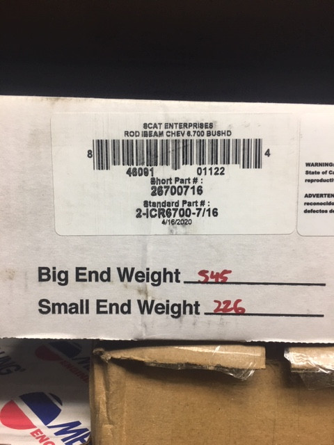

Does anyone have information on Scat's 6.7 I-Beam rod (overall wt, big end, little end)  Scat lists overall wt as 810, but not the big & small end
The H-Beams I have are 815gm total, 567 big end, 248 small end.  No surprise, the weights are very close to My427Stang's data shared above.

545 big, 226 small, 771  total, set built 4/16/20 on the shelf. That’s from the label I didn’t weigh them yet

For Ross:  Can you share the part number for the I-Beams.  Scat lists weight at 810gm for 26700716 or 2-ICR-6700-7/16
Re: Balancing a Scat Stroker: How much Mallory is typical?
« Reply #10 on: June 25, 2020, 06:22:29 AM »
I'll do one better
Here is a pic of the box
Additionally, the last two sets prior to this one, I measured at 544/226 and 541/231 rounded to nearest gram, they must vary after machining and they just group similar weights.  I'd have to guess that number you are seeing is maximum, but I haven't seen one that heavy yet
